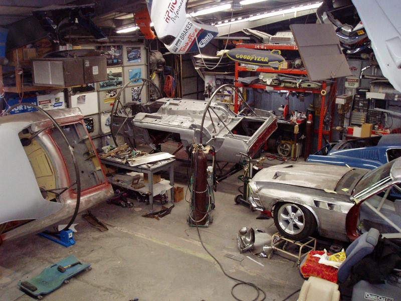

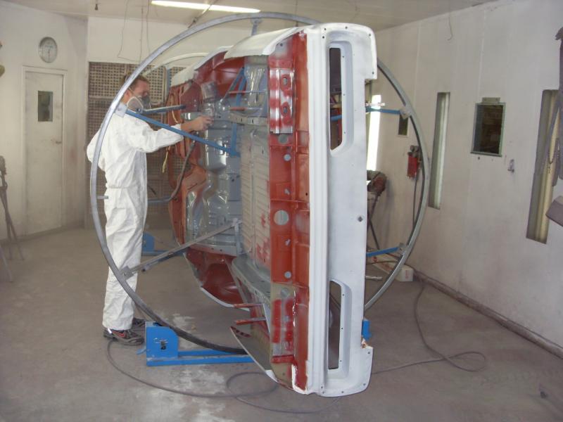

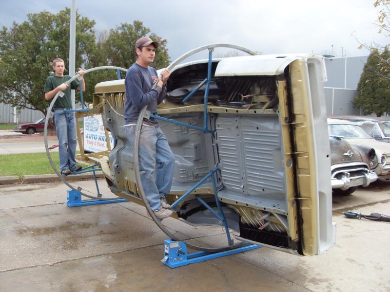

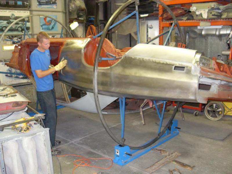

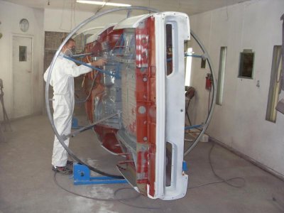

I have a new concept in the rotisserie world you might be interested in called "Roller Hoop" i'm a body restoration shop in Neb. and came up with this design for use in our busy shop. After using my prototypes my guys threw out the end mount units! So now I'm building and selling these great rotisseries to car restoration guys all around the world. I know this sounds like a sells pitch but I have much more interest in seeing all you guys have a much more enjoyable, & safer experience with better results in restoring classic Mopars. So now as of today we are looking to offer the Roller Hoop in a lower $ kit form in which you can save big $ and have some of the fun of cutting and welding some basic parts together and be up and rolling in now time! Just a thought for you to consider we will also looking to join in on this site as a sponsor as soon as I can figure out who to contact.
I saw your rig Doug. Very cool. My fear has always been dropping a car on it's top or side. This idea helps protect it.

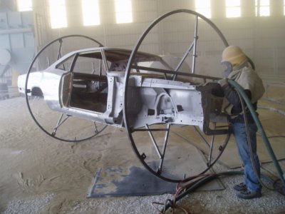

Yes it is safe for both the body shell and the craftsmen doing the restoration work that Super bee was a great project for the Roller Hoop since the rear frame rails were rusted away. it actually was enjoyable to rebuild the bottom side of that car. P1010002.JPG and here is a picture of it getting blasted the guys at the media blasting Love this new set up!
back in the shop on the roller base units it metal work time! then paint bottom side, you can see with the brakes locked it is pretty solid to the ground this is great for when your cutting prying , sanding etc. Just thought some of you might like to see this. I also want to point out notice the rear package try still retains the original factory original paint,even though I had the body shell media blasted as necessary, Please do not blast off all the original paint in hidden areas like this! I see so many guy ruin the originality of a classic by blasting every thing possible! it is unnecessary plus it is extra work and materials and you can never show someone see this is the original color! sprayed on at the factory! Just one of my pet peeves! plus i even save some of the factory runs in the door jamb and on the fire wall my media guy thinks I'm nuts because most all other guys just say blast it all off! Oh I cringe when i see that happen. if it ain't broke don't fix it! P1010001.jpgSDC10795.jpgSDC10974.jpgSDC11046.jpg
