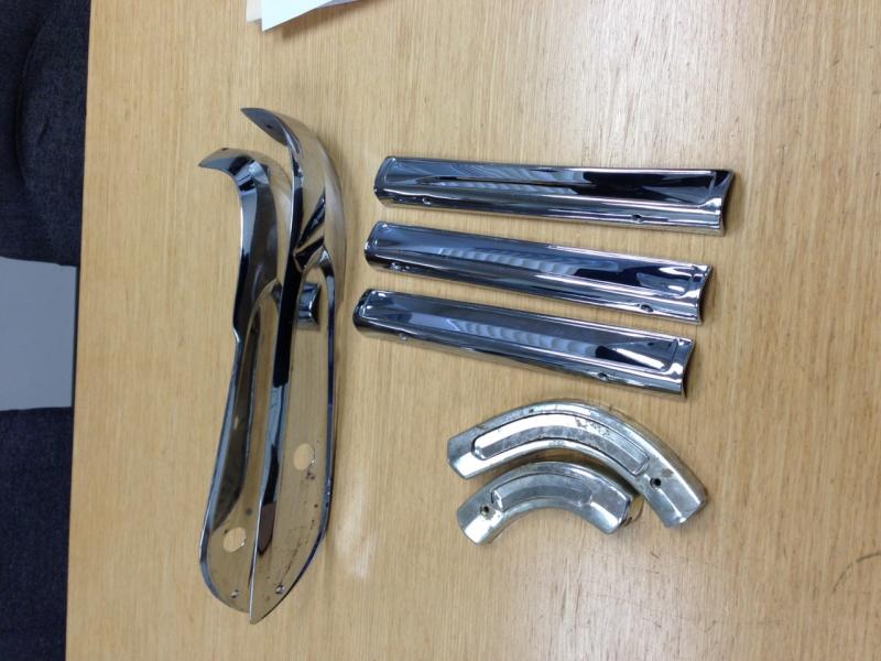

Bought these items off eBay and now I'm not sure what I have. They where listed as 62-65 B-Body - off a 64 Dodge Polara.

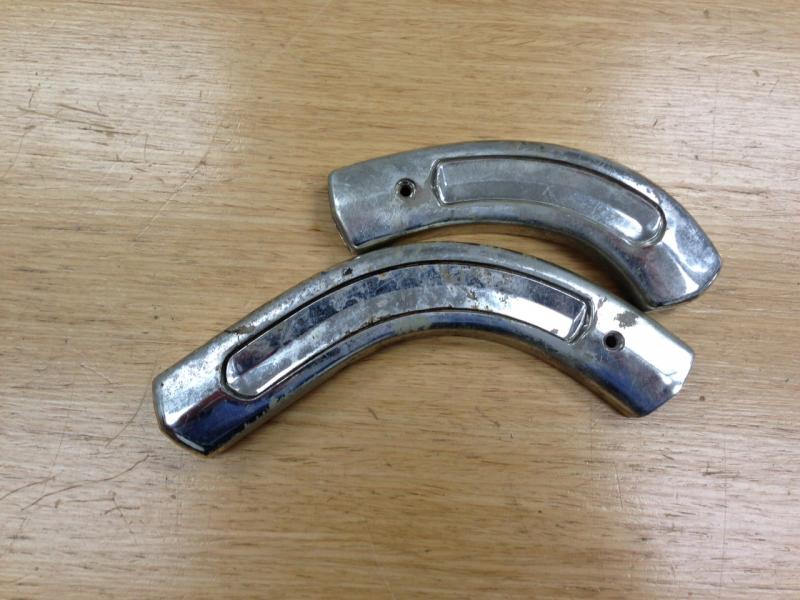

I assume the large parts are for the base of the seats. The 3 "angle" pieces are for the seat back upright corners, but why 3 of them? Lastly why are the hinge covers different lengths?
Better view of the hinge covers.
thanks, Bob
I've never seen the large pieces on a b-body seat I think they are for a C-body bucket! The 3 pieces are for b-body seats should have 4 for bkts.only 2 needed for bench!covers are for bench seats hinge,the small is for an a-body seat!
Dang, I've bought stuff from this guy before without problem and he is a big eBayer so I just trusted the description.

"MOPAR 62-65 B-BODY BENCH SEAT TRIM SET CORONET FURY POLARA BELVEDERE"
How do the "angle" pieces attach? Just sheet metal type screws into the fabric?
