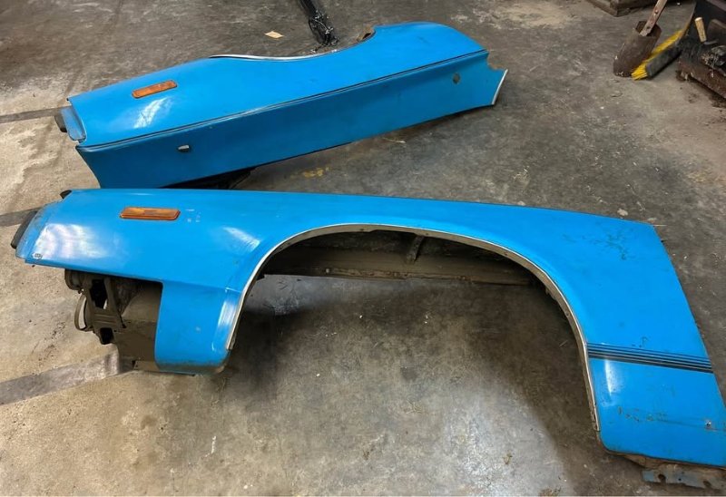

I am not really familiar with the difference between 71,72, 73, 74 Charger fenders. Can you Charger owner's let me know what year I'm looking at here? Thanks in advance
Those are not for a 71 but they could be either a 72-73-74.
Can you get measurements?
72 charger fender is 9.25" from center wheel arch to top of fender.
73-74 is 7.5"
Is the trim on the back of the fender stainless or aluminum? Fender turn signal have a screw on top? It looks like a 72 fender IMO
Look like 72’s. 73-74’s have different wheel well trim and 72 trim won’t fit the later ones.
