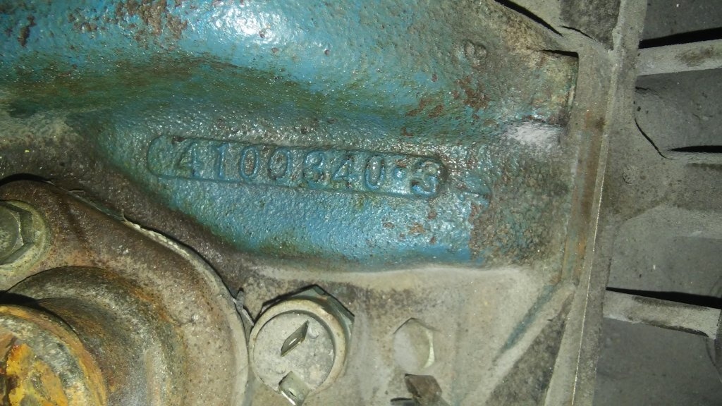

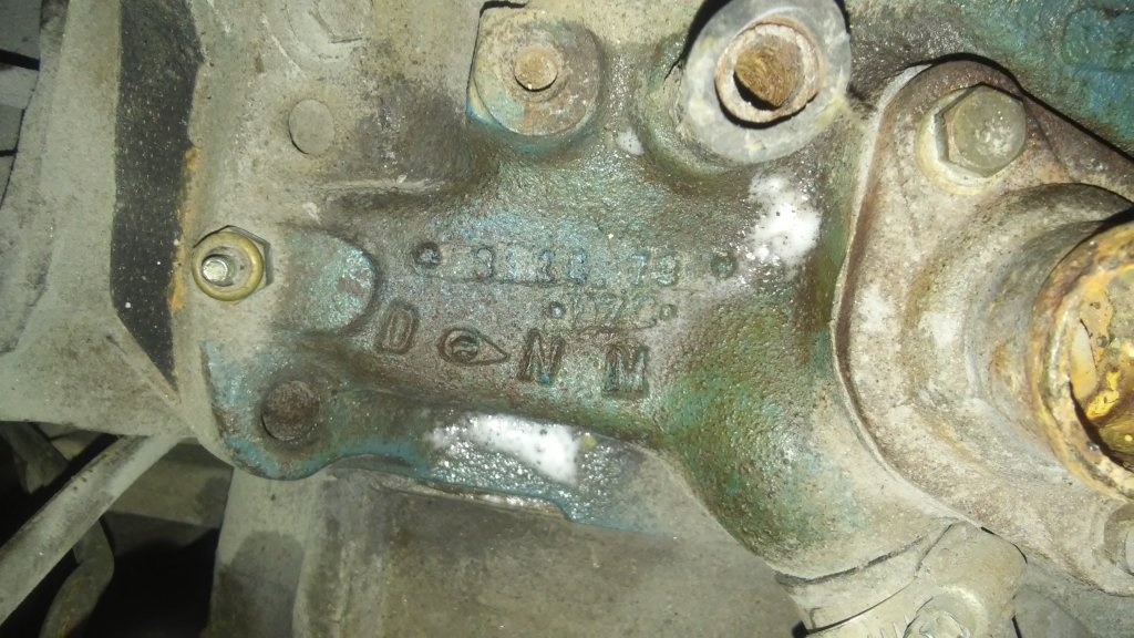

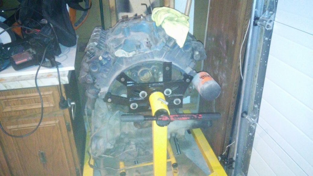

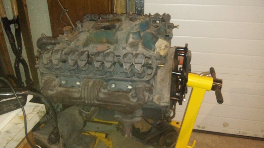

I picked up this motor. I'm still learning how to decode. Can someone tell me what I have?
20160613_225405.jpg 20160613_225447.jpg 20160613_220944.jpg 20160613_225447.jpg
look at the numbers on the side of the block above the frost plugs.
Intake casting indicates 4100340 1978-80 360-1978-82 318/4 Bbl Cast Iron.
