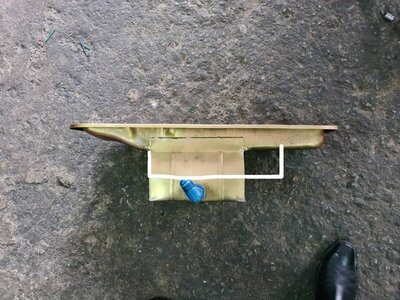

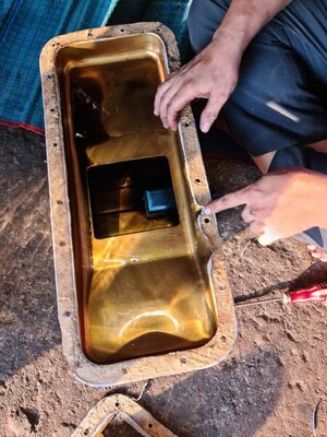

My engine is 572 HEMI GEN2. I use to have a milodon oil pan, but since the ground clearance is not enough. So I broke it. Any advice for oil pan that have a good ground clearance and can contain 9 quarts of oil. If you have link of the product that would be great.
P.s. The picture of my old oil pan is below.

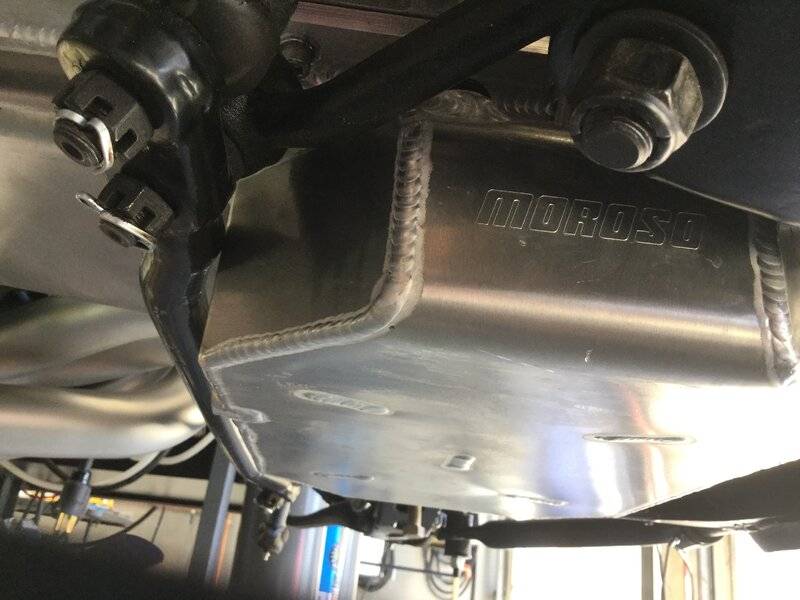

It looks like the center link is hitting the back of the Moroso pan?
I used the Milodon pan with the 1/2" internal pickup. much
cheaper, cleaner, and no chance for leaks with all of the
connections and hose.
Thanks for that zyzzyx u reminded me that i had to use fast ratio idler sand pitman arm to pull it away, with that being said u may be correct on milodon pan. Pictures worth thousand words

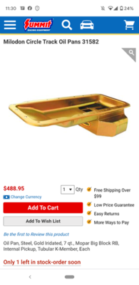

Will this item will fit my gen 2 hemi?.
Go to Milodon's site and look it up. The Gen 2 should be the same as a 440.
It won't fit a Gen3!

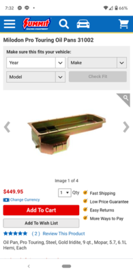

Is this one will fit my GEN2 hemi with Magnum force suspension?
Thank you everyone for the reply and sorry for my English since I'm from Thailand.
That pan will fit your engine. Will it fit chassis? Ad says it will fit tubular k member. Sounds like it would fit your magnum force front end.
If there's a question about fitment, you should call Milodon BEFORE you buy it!
They probably know one way or the other!
