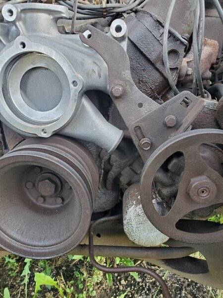

To start things off I thought I would help my dad out with his 1973 charger 400 big block. He had a rad that needed to be replaced so I purchased him one from summit that said direct fit. It showed up and did not have the inlet on the right side like was needed. I contacted summit and they said they don’t have one that would work, I did find that you can buy a water pump housing to come out on the driver side, so I bought him that.(this is all without seeing or being there to help him) he installed the housing and now the rad will work for him, problem is that the hose would have to run through the belt and the power steering pump is kind of in the way.
was wondering if anyone had any experience with doing this? I really regret not being there to help him otherwise I would’ve got him to return the rad and purchase one from a different company.

find the proper power steering mount brackets
My 66 hose comes off that side
I will try to find this bracket you are talking about. Any suggestions on where to look?
I appreciate the help

All of you above, quit 2nd guessing him and coulda woulda shoulda. My '67 water pump inlet is on the driver side also. Not sure part numbers, but TN Mopar above has a 66 n mine is a 67, so I'd be looking for power steering bracket for bb Mopar of those yrs. Yes, totally understand the frustration when they say it's a direct fit.
The only problem with the above suggestion is different power steering pumps. The 66-67 is a federal/TRW style and the newer one pictures in post#1 is a saginaw style I believe. The brackets that bolt onto an earlier style pump won't fit the saginaw, so probably have to look for a 70 style and up bracket set for your style steering pump. I have included the link for the saginaw style brackets for a 69 and up from megaparts, but make sure on fitment as it's only a suggestion as to what you have from the pic.

Get a bracket for the PS pump to relocate it. Call Tony's parts. You'll need to get the proper size belt to make it work.
Check 440 source for power steering brackets I believe they sell them
