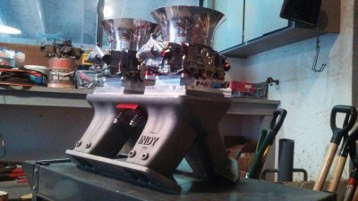

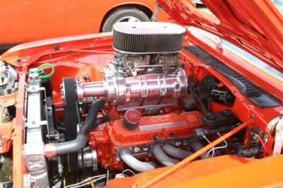

I know people will disagree. Why not run Edelbrocks? I run them on my small block blower car and my 572 Indy powered 64. Both drive excellent. Power? The Volare runs 11.0 in street trim, the 64 went 9.180 2 weeks ago. You won't find a larger plenum than is on an Indy crossram, no tuning issues. Carbs are stock except for chokes removed and a second fuel line added. And they're cheap.
Doug

Went with ProSystems got two 780 cfm.. Black finish
Thanks
