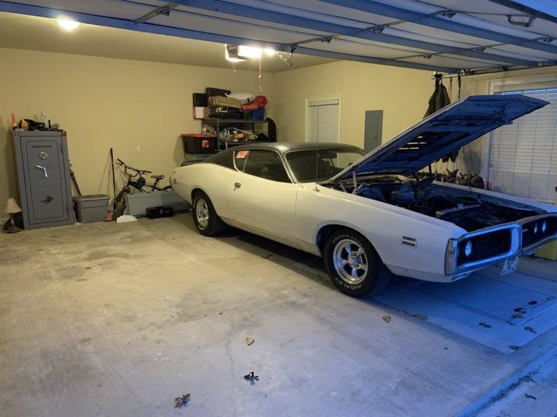

Hey all, still plugging away on my grandfathers mopars that I picked up last year.
The 71 Superbee is officially a driver, I’ve poured a lot of money and sweat equity into her, and it’s finally paying off. One of the biggest mods I’ve made for reliability is converting the car to a MSD ready to run distributor system and I’ve converter to a high amp one wire alternator.
My questions now revolve around bypassing the factory ammeter. I no longer have a wire going from the alternator to the voltage regulator (it’s gone) and then to the ammeter, so how do I go about a bypass? Would I just drill out the firewall connectors and then run wires from the starter solenoid to the factory ammeter wires? Do I even need to do this now that all current being driven to the ammeter is routed from alternator, to battery, to ammeter?
looking forward to hearing from you guys!
