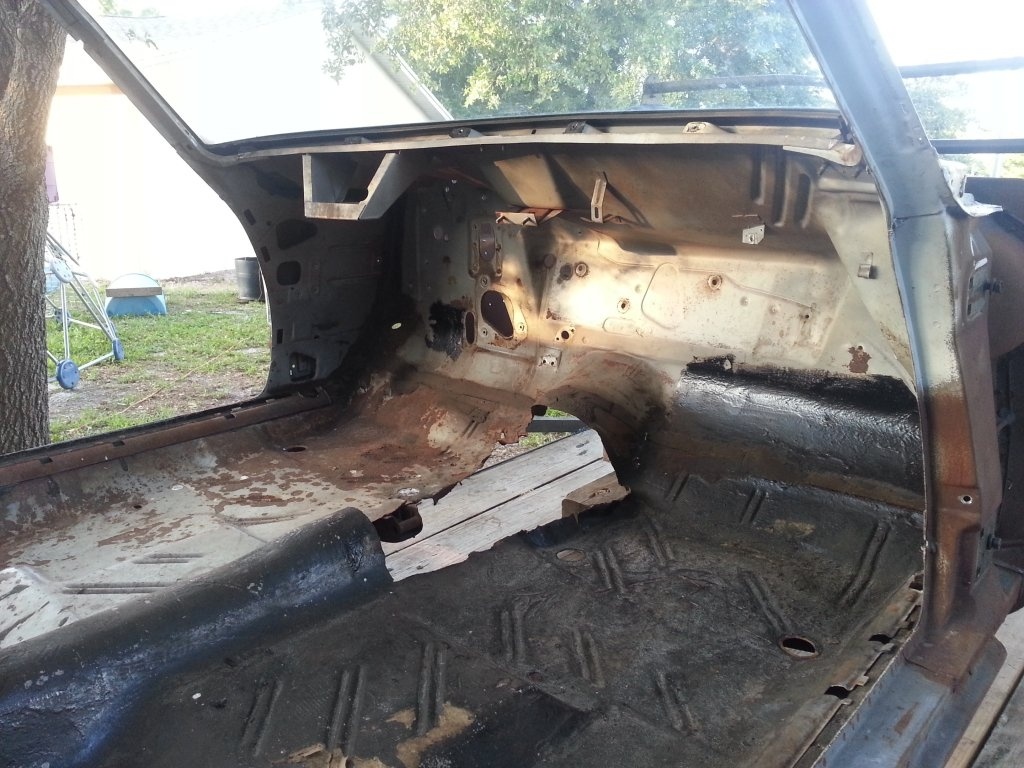

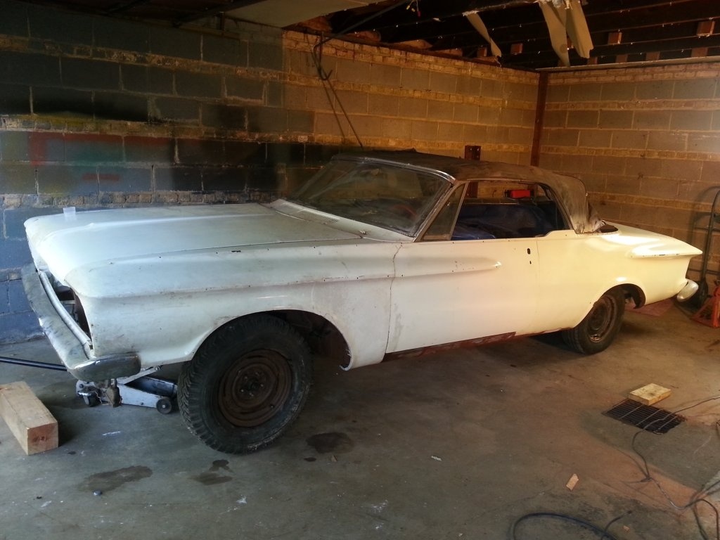

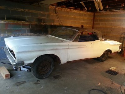

Here is one before it was dissembled completely and one dissembled. It currently is 100% striped and and bolted up to my rotisserie. it was supposed to go to blasting on Wednesday but the warehouse i was going to be storing it afterwards was damaged by a forklift so hopefully next week or the week after. I have all the trim and interior ready to go back in when ready. Once the body is ready i need to start on the power train. The only reason i am blasting is my uncle thought it was a good idea however never finished so now i have some surface rust on the under carriage but none on the rest of the body. It was in pieces but garage kept since 67 it has 33,000 on it.
