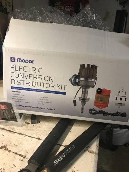

I’m trying to install the mopar electronic conversion kit in my ‘70 Belvedere. It has points and a 2 wire voltage regulator. Does the Vr stay? If not, what happens to the green and blue wire that plugs into it?
VR stays.
Ignition Control Module will be the additional piece (pictured on box).
I fought that style upgrade for weeks before I endedTaking it back for an HEI style. 50 bucks cheaper and much better performance. Cleans up the engine bay too since it was all in one I was able to pop the old module off the firewall and relocated the coil to be more hidden
How about the old ballast resistor. Is it replaced by the new one?
use the new one that came with the kit
make sure the ECU is well grounded, take some sand paper and scap some paint off the back of the ECU wear the bolt holes are and were ever you mount the ECU on the car to get a good ground
Thanks guys. It fired off without a hitch and runs nicely. I hope the performance curve is better than the stock distributor!

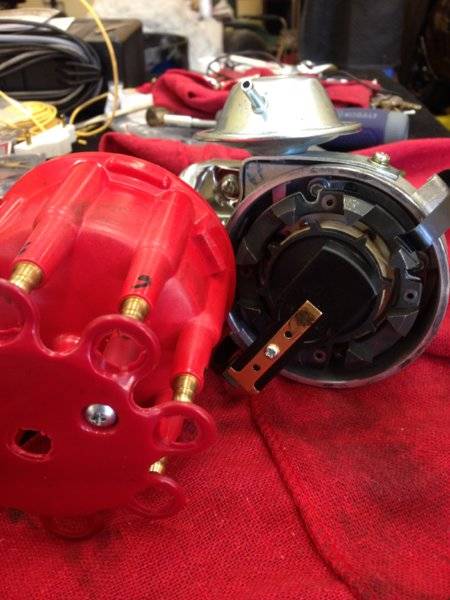

I recently installed a 440 crate motor from Blueprint Engines, and I believe I have one of the distributors you are talking about. How do I identify it? There is no brand name, no part number, etc. Blue Print couldn't offer much help. I am not sure of the wiring. I'm told it is a "plug and play" distributor. I'm having trouble getting it to run right, and am getting suspious of that distributor. Any help would be appreciated!
Please take off the cap and give me a picture looking down inside it.

Here's the pic of the distributor. All testing and 3 mechanics pointed to the distributor as the problem. And we were right. Dropped in a Revco Distributor and she fired right up. We just didn't want to believe that a new engine built with top of line parts would have a defective distributor. BluePrint Engines really didn't have an answer as to why they put a $50 distributor on a $9000 engine. Live and learn!
Ok, So Revco Ignition? that has Google and I both baffled, what is it? Where did it come from? Is it mag trigger or Hall effect? Is it a self contained ready to Run or does it connect to a box?
Where did they set the initial timing? Where's the total timing? What RPM is it all coming in at? Where did they connect the vacuum line? Ported or constant?
