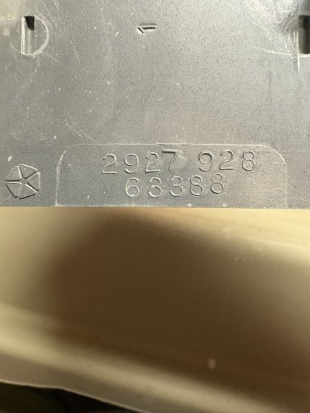

need info unpainted radio delete part no.292792863388

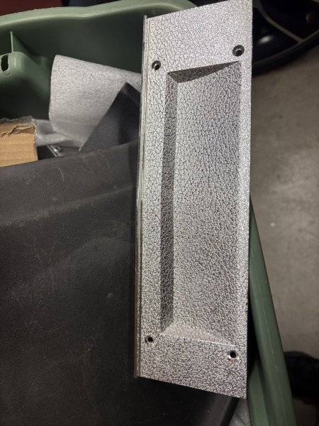

Several inaccurate replies above. The radio plates with 4 screw holes (as you show in your pice) are 1970 only. 1968 & 69 plates only have 3 mounting holes. All 3 years are different. There were quite a few 1970 unpainted bezels (delete and am style) floating around years ago. I assume they were left over stock from the original vendor. That bezel is a perfect candidate for a car that had radio delete with the woodgrain dash trim. These were unpainted from the factory and all that is needed is to cut the 4 slots in for attaching the woodgrain overlay. I have an NOS one with the woodgrain overlay on hand.
