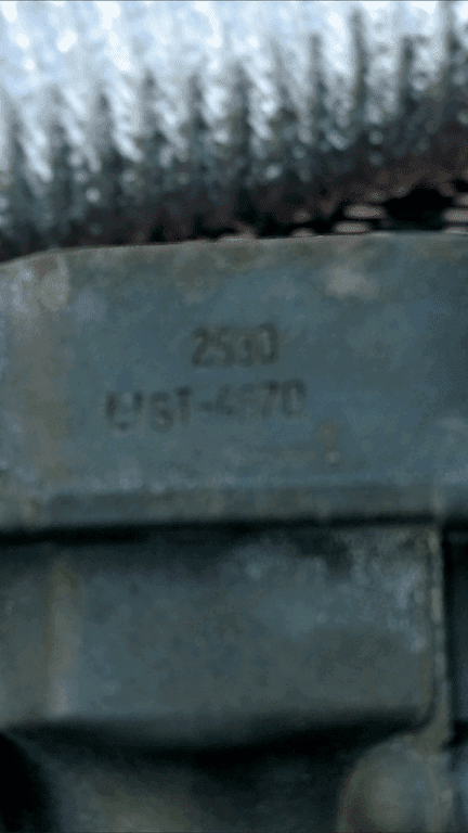

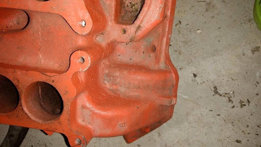

Hey guys im looking at a six pack set up but need to know from someone with experience what im looking at here and what would be needed to actually put this set up to use.

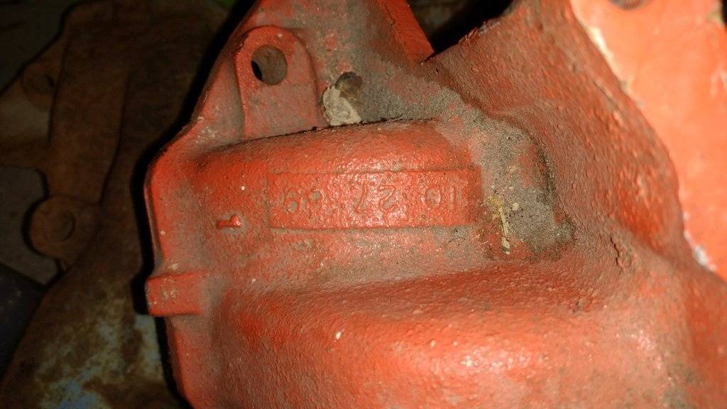

its a 70 manifold
they built 70 model year cars in late 69

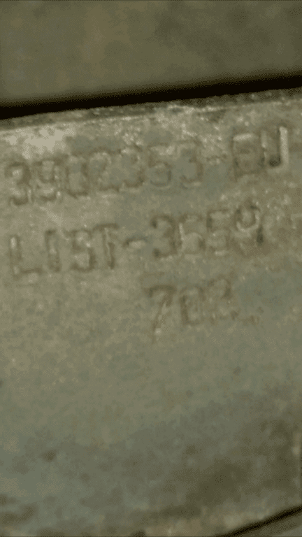

3659 is a 69 corvette carb number
and i cannot read the other list number is in the pic???

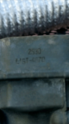

4670 is a 71 center carb
so its a mismatched set thrown together.
it might work ok but you would have to show
more pics to see if all of the parts are there.
how much are they asking for it??

it is a mismatched carb set
a mopar center carb with chevy outer carbs
someone might pay 1500,it wouldn't be me
i would offer a grand at best

The 69 manifold is a heavy boat anchor & the only way I'd want one of those things is if I were restoring a car that needed one with that date on it. It's pretty much an identical copy of the aluminum manifold & the only advantage for aluminum is a weight savings. He probably won't go for it, but I'd offer him a hundred bucks for the manifold only & tell him to sell the carbs on a Chevy forum.

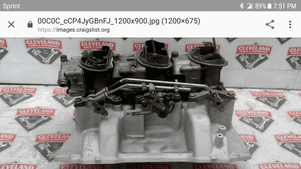

Got a question for you. I came across a six pack set up now with these carb numbers
the Holley Factory Replacement has the numbers 4672-2209. The other two appear to say Chrysler / Eddlebrock 3412048.
What are these aftermarket replacements?
