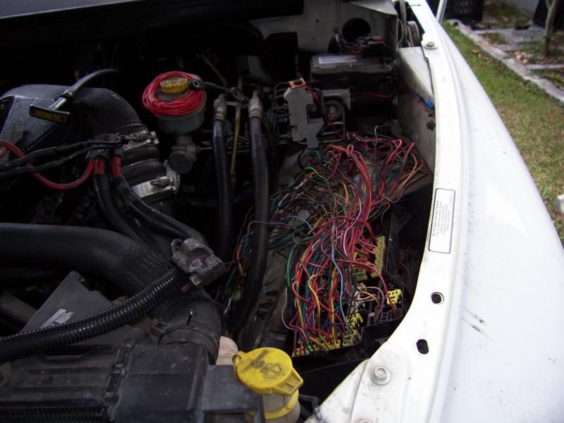

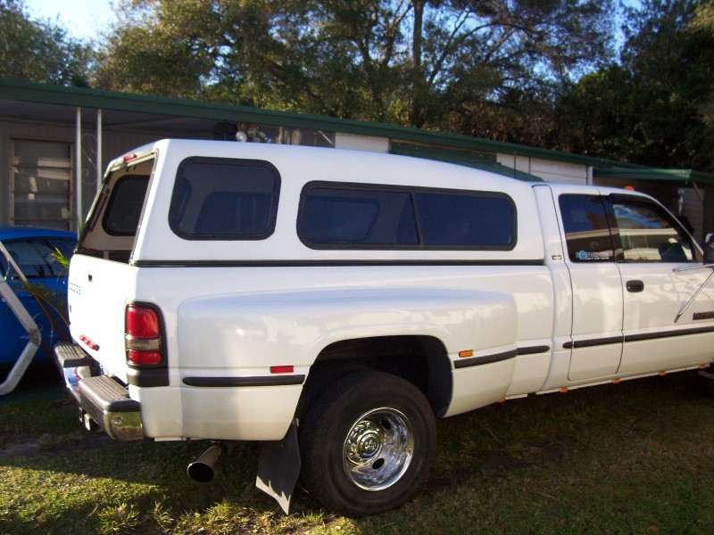

My beloved 98 cummins dually [white one pictured] had a fatal wireing harness short in the engine bay this past monday,i'm waiting on insurance adjuster to come take a look i'm unsure of what may happen [i'm expecting the worst]but trying to be optimistic.Anyways if they total it i have to replace it with another daily driver or use my 66 cuda as my olny car [i did not purchase it for that] and due to computers and heavy electronics in the newer cars i have chosen 3 older cars and one newer cummins truck.I'm over these newer vehicles that cost an arm and leg to repair. Written sugesstions are welcome.

i voted for the dually,cause you need to replace the truck with a truck. IMO.

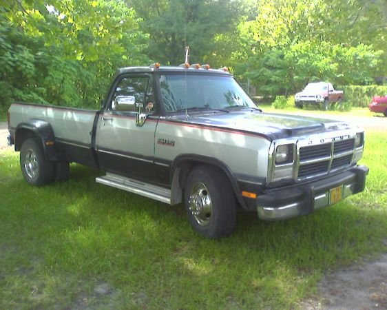

That 91 is just getting broken in. If Moby Dick there gets totaled, what's the buy back for parts for the 91 or a flip to get more Cuda money?

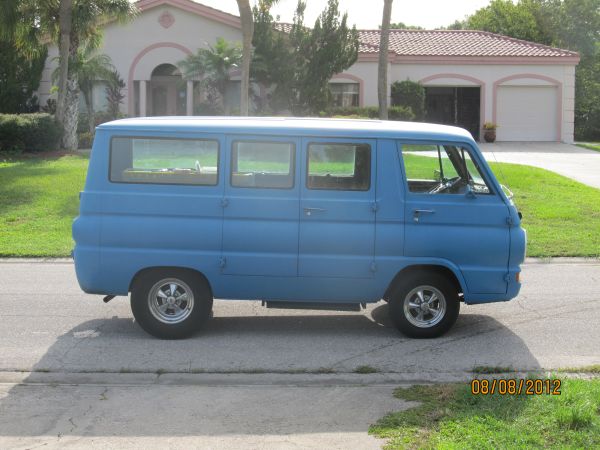

A truck should always be replaced by a truck - unless there's a really cool looking classic van as an option. That's why I voted for the van. :happy7:

I'm torn i never really used or needed a 1 ton dually [just wanted this one] but my long term plan was to buy a racecar hauler with living quarters to travel in when i retired [in 8 years] but i have always thought the a 100s were so cool looking and a v8 one to boot therein lies my problem i need a diesel truck to complete my plan [which may change who knows] but the van is so cool. We'll have to wait and see what the insurance says.

Have a look at the big wire off the alternator where it rubs against the alternator bracket. My 99 rubbed through there and grounded out. I feared the worst as the dash went nuts and the truck died. It took very little to fix and nothing was hurt. One year later and no problems with any of the electronics. Good luck.
Yeah, what happened anyway?Why fatal? Did it burn to the ground? In which case,yes that is a I need new wheels situation.I cant decide.I like the d100 but the 91 would probably serve you better since it is closer to what you had. Even though dually's are pigs. Man, this is a tough decision isn't it.hahaha

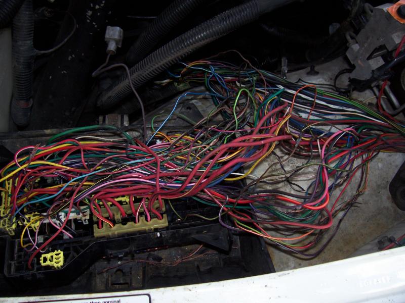

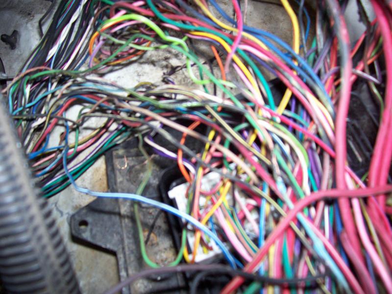

The harness just behind the engine bay fuse box melted and the wires in the box melted as i was parking in my yard [thank god] no fire just stinky smoke.I pulled the tape off of the harness and the bottom off the fuse box and the wires are roasted [not all of them about 1/3 of them].After it happened [before i tore it apart] i turned on the key and checked what still worked everything worked except my wait to start light did not come on,i even tried to start it and it fired up and died instantly [fuel shutoff] so i'm hoping i just need a harness replaced or repaired. I don't want to have to replace this truck but we'll see what the adjuster says. By fatal i mean she is dead at this time but i suppose she can be brought back.

I would like to say the 64 Belvy, it would be fun & cheap to drive, but the 91 Ram Cummins 5spd "diesel dog dually" is a better choice to replace another truck... I would think the insurance adjuster will say, "it needs, batteries, ground straps, engine bay & under-dash harnesses, fuse panel, relays, computer or any other associated wiring components, or other parts that were affected, in the melt down, probably all caused because of a bad ground strap somewhere, seeking ground"... I doubt they will "total it", but it won't be cheap either... Good Luck, Happy Moparing, I've had a couple 95 & 98 2500 Ram 4x4's w/5.9ltr. Cummins they both went easily 350k+ miles before getting rid of them, both were "hot rodded" with bigger turbos & larger inter-coolers, larger injectors, jacked up fuel pump timing & high flow fuel filters & K&N air filter, they were still both running very strong even after all those miles & mods... Good Luck & Happy Moparing

If you get the van, you should paint your 66 Barracuda on the side.
That would look beautiful! Wouldn't that be cool someone telling you how cool it looks when your out in the van and you ask them if they would like to see the car that modeled for the paint scheme... Makes me smile thinking about it. I cant imagine what that would cost to do though... cool as it would be.. :)

Hate to say it but they probably gonna fix your truck dude they could replace entire harness for way less then 50% its worth they will send it to dodge dealer
