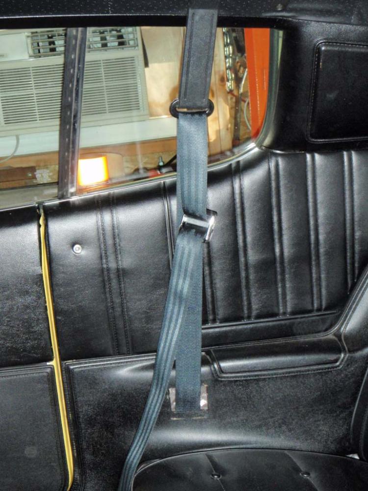

I pulled 74 Satellite seat belts out of a car a few years ago to put them in my 73 Road Runner. The metal bodies of the cars are physically different, and the 74 seat belts will not bolt up and work in a 73 without a lot of modification. The 74 metal body has a cavity to mount the retractor. This metal cavity does not exist on a 73, so you would have to cut and weld in a piece from a 74 to make it work like factory (plus get the belts and trim pieces).
In the end, I bought standard retrofit seat belts, and mounted the retractors inside the rear trim panel. The belts route up through the ash tray hole. This means no cutting, no modifications, and 100% reversible if I ever wanted to.
To finish this out I would like to get a slotted cover for where the belt comes out, but it works well so far.
Just food for thought...
P.S. I still have the complete 74 seat belts laying around somewhere if someone needs them. Won't do me any good...
