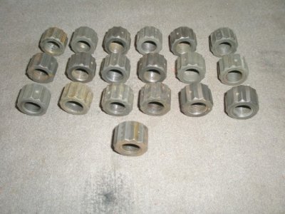

I need to buy what looks like a 12 point socket for the strut rod nut where the rod attaches to the backside of the LCA. Anyone know what size socket works? 1969 GTX 4 wheel drums.
Thanks
7/8 Socket, 12 point.
