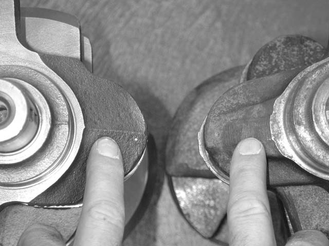

Sounds like a balance problem of some sort. Here is how you tell cast vs steel. Cast cranks have a pencil thin parting line, like on the left, while forged cranks have a very wide parting like on the right, or sometimes none at all. You MIGHT be able to tell looking at the flywheel flange, but most likely you'll have to drop the oil pan to be sure.

Rusty: Nice comparison picture of cast verses forged crank. Should help a lot of guys. Thanks for that.
