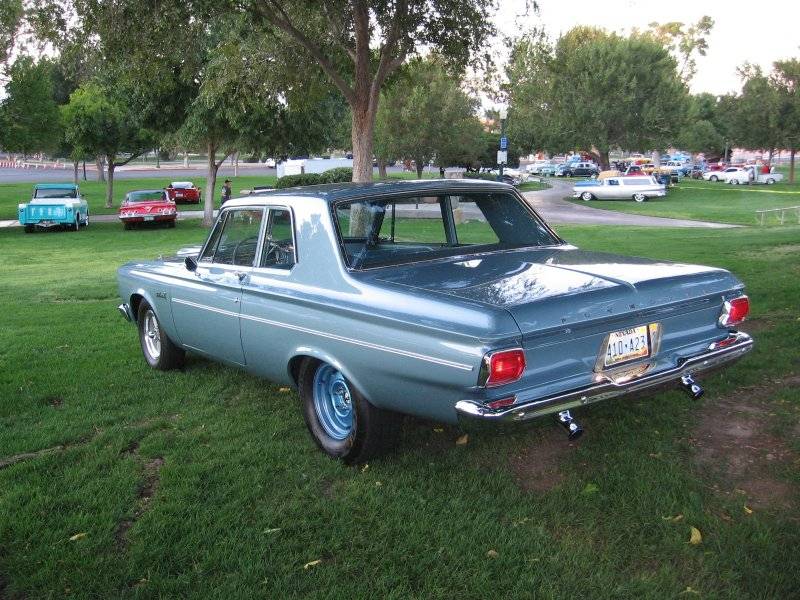

This is a photo of my 65 with the factory steel wheels using 275/60/15 tires. They fit with no modifications.
No 2 Mopars are the same. 1/2'' negative backspace may be fine. Out of the 5 63-64-65 B bodies I had 275/60/15 fit fine on 2. The other 3 rubbed on one side and that was the passenger side.
