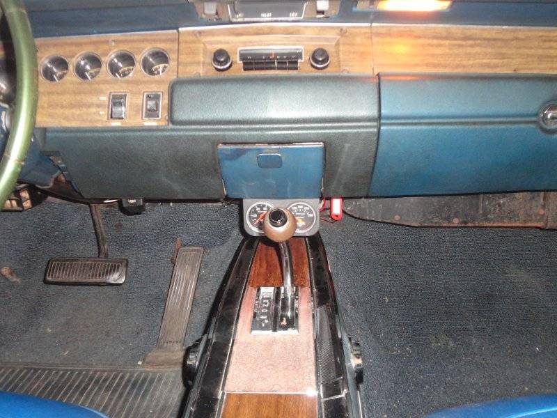

Of course the Am radio in my GTX doesn't work, and I'm not spending any money to get a radio that will fit the dash. On a previous post about radios someone posted a small box that would drive some speakers and had multiple inputs, and Bluetooth too. I think they might be made for boats. I would like to go that route if anyone knows what I'm looking for. I can't find it on here, and my internet search has been frustrating as I don't know what it might be called to find it. Any help would be greatly appreciated.

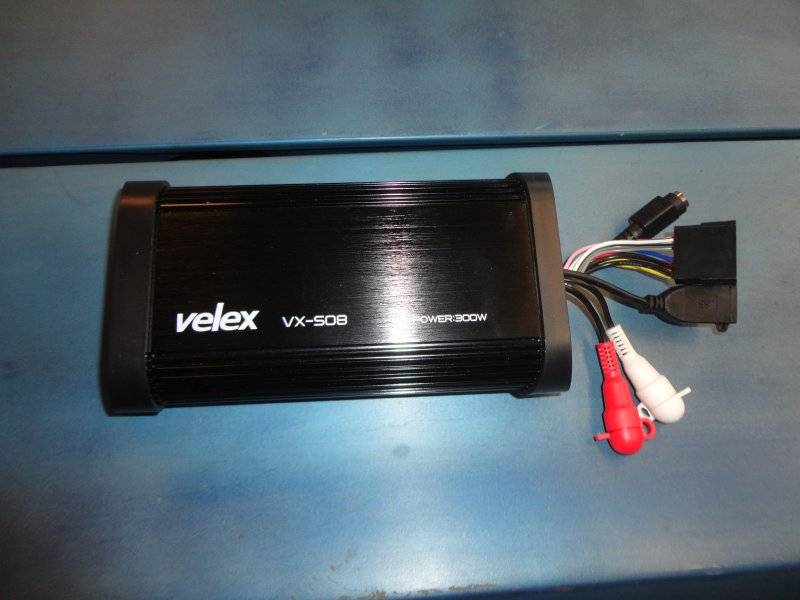

So I got the radio/amplifier installed and hooked up in my GTX and it works great so far. Here's what I got and how I installed it.

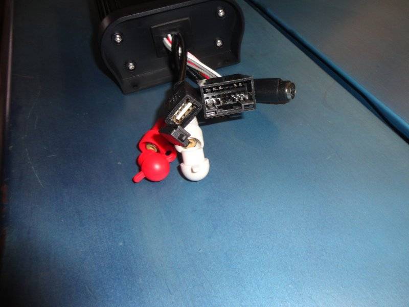

I got this VELEX amplifier from AMZN that is made for use in boats, atv's, motorcycles, pretty much anything offroad. It is waterproof and all sealed up.

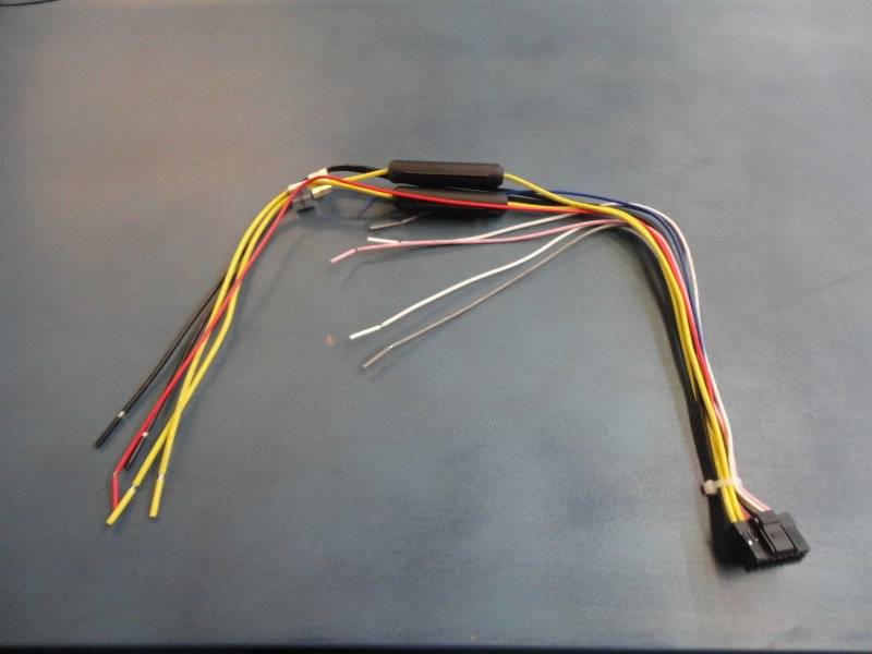

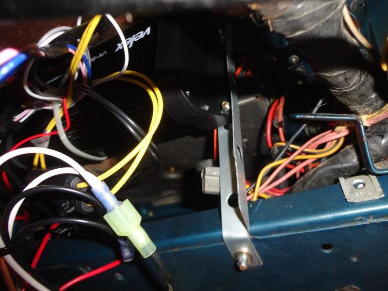

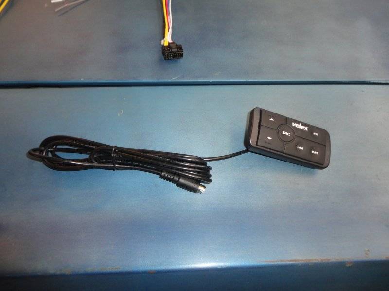

As you see it has a wired control head and connections for USB, RCA, and Bluetooth. 3 pwr wires, 2 with inline fuses for the amps that are hot all the time, and a wire to a keyed source to turn it off and on. It even has a wire for a pwr ant. I mounted it right on the back of the radio with a couple of brackets I fabbed up because it only weighs a couple of pounds. Ran all the wiring for control head, plus my XM radio into the console out of sight.

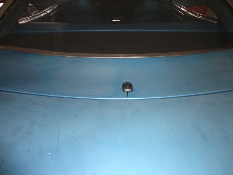

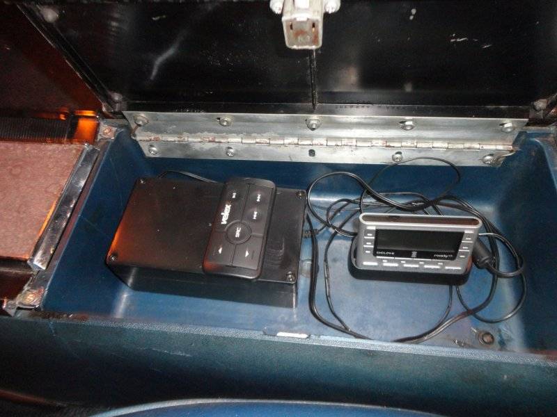

Here's the control head and my XM radio in side the console and the ant for the radio which is a magnet that I can pop off and stick in the trunk when I don't want it seen.
As you see it is not visible from inside at all. I have a flash drive with music on it plugged into it now with the orange tag on it. I've ordered an extension for the USB so I can put it in the console also. When you turn it on the pwr head has blue background color meaning it is on bluetooth. If your phone is paired to it, it will say connected. You push the round button once and it turns purple and is connected to aux. which for me is my XM radio. Push it again and it's red and connected to USB. It has volume control, 4 preset tone settings, next/prev song for the USB. Pretty much does it all. 2 400W Kenwood 6x9s in the back work great.
