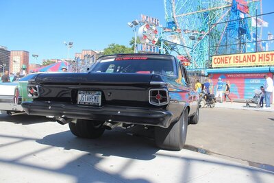

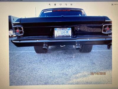

Help, On the lookout for 2 each 1" wheel spacers for 1/2 " stud 5x4-1/2 pattern. My narrowed rear end is to narrow :-(

Might I suggest installing longer wheel studs and using a hubcentric spacer made of billet. NOT normally a good idea to use spacers on the rear!

What is the intended use? If traction is in the plans maybe a rim with less backspace might be better..........

I found some spacers that will work. I wanted to install my vintage Sox & Martin Keystone wheels and found the offset 1" to deep to clear the wheel tub. I already have extended studs so the spacer will fit good and safe. The spacers I found have the centering lip.
Thank you all for your help, Looking forward to hearing my 440 thump again. It has been over 30 years since I got to lay some real American rubber !
