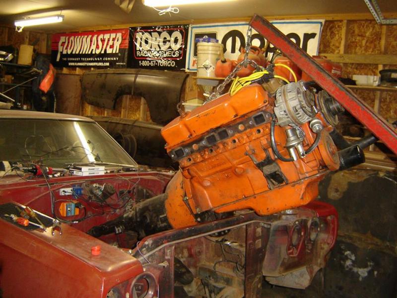

I've always dropped the engine/trans thru the top. Just be careful, and pad out the engine bay and tape a towel over the trans tail. I've done this several times on an acid-dipped front-end car....without leaving a mark. Just have 2-3 people who'll really help and watch.

I've always gone in from the top with the trans bolted to the engine. If you have a load leveler, you're a step ahead but if not, I would let the tail of the trans 'land' on an old creeper and it would roll back as the engine came down and just as the motor mount brackets were close, I'd jack up the trans a bit and lower the engine the rest of the way. Just make sure the trans lands on one end of the creeper so you still have a good area to place the jack or use a car dolly instead of a creeper. Btw, seems like whenever I needed to install an engine, all my buddies were at work so I became a one man band. It was me that always had the strange work schedule and is pretty much why no one was around much and over time, having help only slowed me down.
I always put the rear axle up on jack stands as high as I can get it and remove front wheels/tires and set the front end as low as I can get it (rotors an inch or so off the floor), but so that a floor jack can just slip under the K member. I use a cherry picker with a load leveler and install the motor and 4 speed together and let the tail shaft land on my floor jack, aligned so that it will roll backwards. Always by myself, slow and easy. Everything on top covered by heavy moving blankets ($3.99 on sale at H/F). Works for me...
as long as you have an eng tilter for your hoist and put the cars rear up on stands,the eng and trans will go in easy as an assembly from the top.lots of potential prob loading from bottom without a rack.

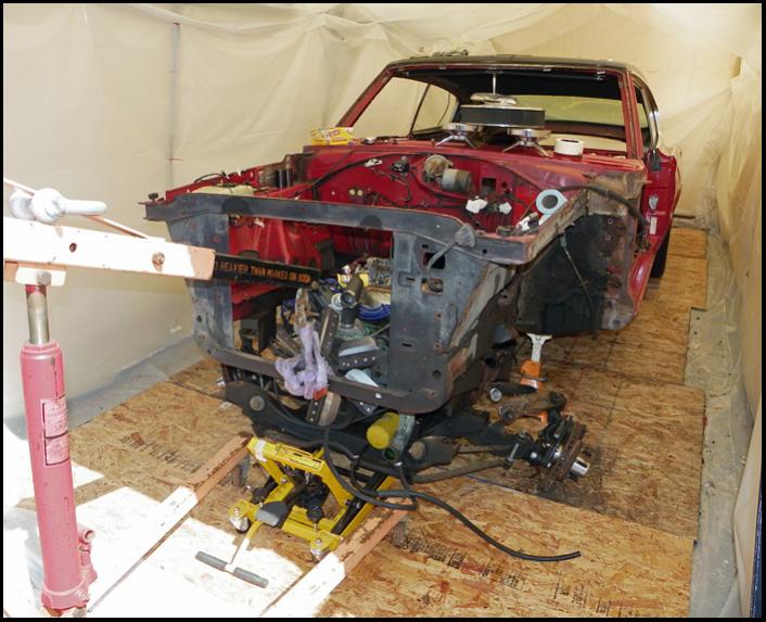

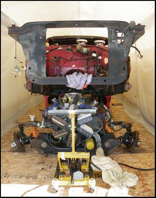

I guess I must be all bass ackwards... I pulled the bolts on the k-frame, the upper control arms and trans mount, then slid everything (engine, k-frame, suspension, trans etc) out the bottom... piece of cake. It's going back in the same way.:mornincoffee:

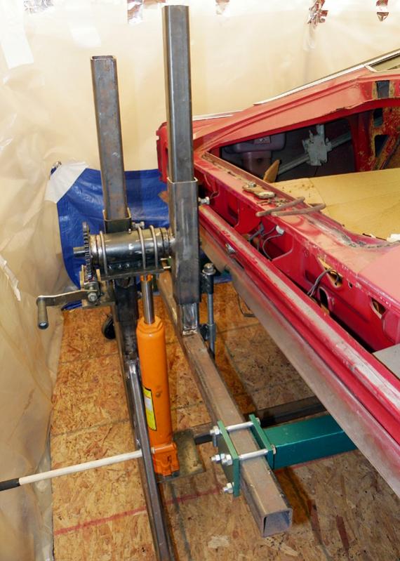

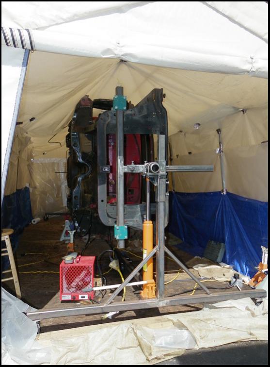

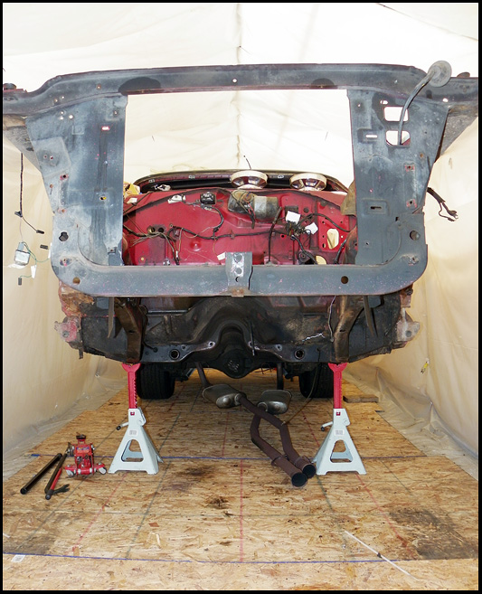

I slid the rig (HF ATV lift) under the k-frame, unbolted everything, and lowered it all down before lifting the body. After that, it's just a couple of jack stands to hold it up there once you've lifted it up high enough. Now you can roll the lift out of your way and get busy. (see images)
67 Mopar, I like what you did there. That's a pretty slick deal.... but what if you want to move the car while the engine is out?
I was starting a resto there, so the body went on the rotisserie shortly thereafter. However, I could have just as easily mounted two wheels to the front bumper attachments if I wanted to move the car around. No biggie really...
I didn't have to lift it very high... I couldn't even if I wanted too... I've done the entire resto so far inside one of those temp shelters... the electric twinkie!

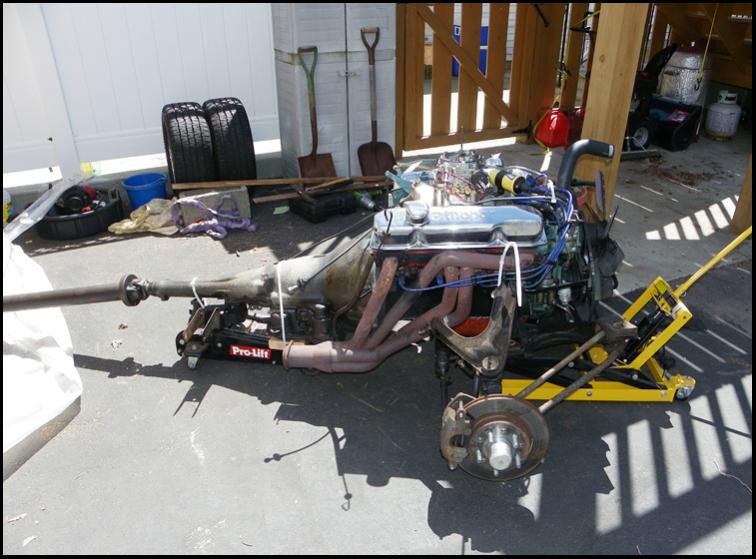

I took mine out from the bottom, as one large assembly with engine, trans, K-member, suspension, etc. Now I do have a lift, so that makes it easier.
Having said that, I think going from the bottom is still the way to go - why? How much of a PITA is it just to install headers? What about every other bolt on? When going from the bottom ALL that stuff can be on the engine and trans and ready to go. I believe it will save you TONS of time overall to go in from the bottom. Yes, you have to figure out how to lift the body, but as 67 Mopar showed, it can be done quite nicely.
Just my $0.02
Just as an FYI, Total time from the engine/trans on the floor to the headers installed on my Road Runner was an hour and a half. That included shifter, clutch linkage, driveshaft, starter and headers. I have yet to install radiator, hoses etc.
