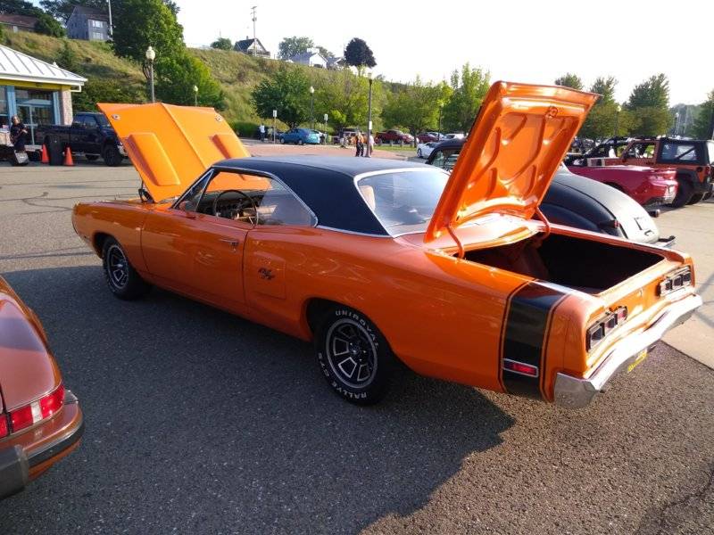

I've run 235/60r15 tires on 15x8 wheels front and rear for years but now would like to run a pair of MasterCraft 275/60r15's on the rear of my 1970 Coronet R/T. Has anybody run these on their 70 Coronet that can recommend their fit, and also recommend a front tire size using the same 15x8 wheel. 235/70r15 maybe? I'm only interested in a level appearance, not a jacked up look. The pic shows the wheels I'm using.
That is a good tire combo, that is exactly the two sizes on my 68 Coronet R/T.
I have 235 up front and 275 on back Cooper GT

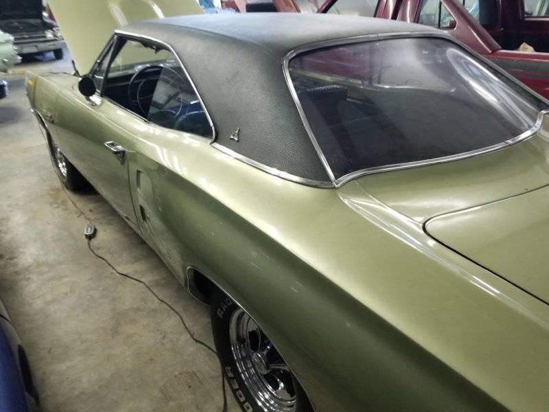

My RS23VOA******* has 275-60-15 on all corners with standard Mopar rally wheels. I've had this combo for years without any issues. They are BFG TAs with letters inside.
