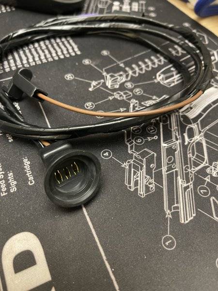

I am assuming there is no polarity on the connection to the transmission on my 1970 Sat’s neutral safety switch/reverse light harness. Correct?
Looks like brown center is the neutral safety open in gear and short in park and neutral?
So the other two (blk and blk-t) must be power and reverse lights?
Thank you in advance for providing clarity.
So new cable and new switch no bueno. I did the test with the motor not running and had it in reverse with the lights on and ignition on.
I have power to the neutral switch as measured at the engine side bulkhead D. But no voltage at C ie switch output when the transmission is put in R.
I don’t know what “makes contact “ or how inside the transmission. I assume it’s like a mechanical slide? I also assume the engine doesn’t need to be running?
So in summary trans in R, ignition on/engine off, 12V @D no voltage @C. New harness and switch.

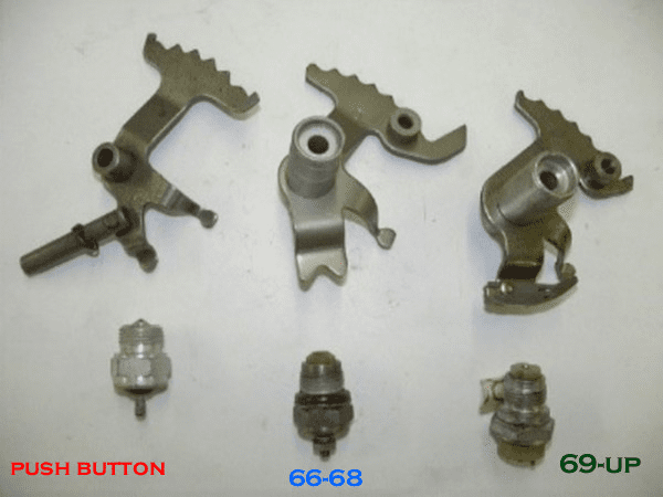

You have to make sure the NSS is matched with the rooster comb in the transmission also or it will not work properly. If it was rebuilt who knows what is in it. Also did you test the switch itself out of the transmission?
I went through this goat rope.

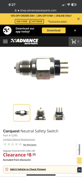

Is there continuity through the outer contacts of the installed switch in reverse? If not, pull the switch, depress the plunger, do you have continuity through the outer switch contacts? Ensure there is only one seal in place, have seen inadvertently doubled up seals interfere with the switch function.
I checked with my multi meter the two contacts at the end of the harness. I had the meter on audio ohms. As I passed through neutral I got a momentary contact only but sitting in neutral nothing. I am going to pull the switch and check it.
To be clear, should only continuity between the two outer switch terminals in reverse, no other gear position.
To be clear, should only continuity between the two outer terminals in reverse, no other gear position.
Yes right. What I see is that I can get continuity when the shifter sits between N and R. Like it’s a contact alignment issue.
I tried getting the switch out of the trans but it’s very difficult to get at. Any idea on the size hex it is? I can’t get an adjustable wrench in there.

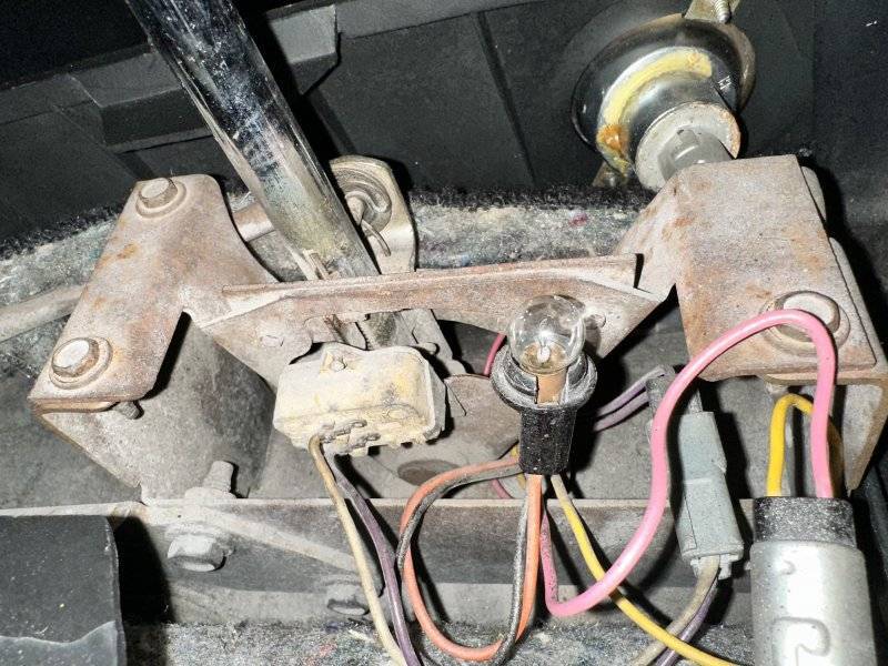

My reverse switch is in my console on my Charger.
I spent a lot of time getting my switch adjusted.
With your meter on the two switch leads you should get continuity or an audible tone in reverse only.
Shifting into Park no tone. Reverse tone. Drive no tone.
As I said adjusting switch position was tedious for me.
Not sure if you chasing starting issues or reverse light issue.
Disregard if this is not your situation, just passing on past frustration with my switch.
Just reverse light issue. NeutralPark detection is good. The access to the switch is a pita in the tunnel for me. How did tou adjust? Washer thickness?
Not sure what you mean by tunnel.
My console was out at the time and it was still hard to get to the mounting screws. My adjustment came from moving the position of the switch, I didn’t shim.
Here is a pic from internet, yours might be different.
I believe we are talking different years and possibly different things? I am referring to this 1970 transmission switch. It located on the trans in the tunnel under the car.
