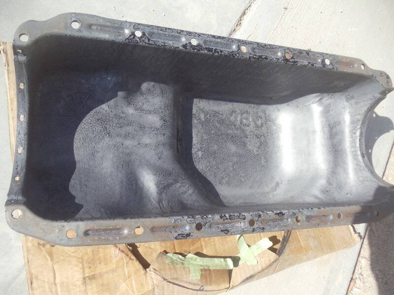

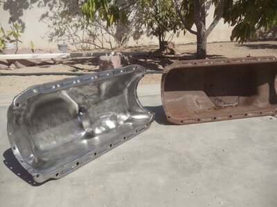

And a couple of buddies like: water, powdered laundry detergent, wax & grease remover, oven-cleaner, scratch pad, naval jelly, power drill, wire brush attachments, sand paper, vacuum cleaner. Then Ospho inside; Ospho, primer, and paint outside.
Very nice! One more to go.
Perseverance and determination too!
Looks great!!
