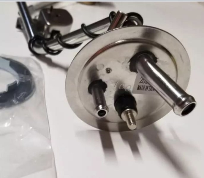

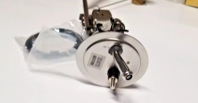

Vans-Auto one, I can see the tag it says "Made in Tiawan",
you also can see the 'Chinese scribbling' too, another words Chinese-Taipe

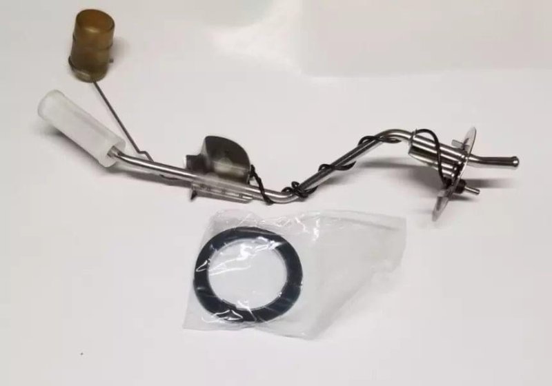

I bought one for each from Mancini Racing, Flint Michigan
for my 2 (then) 68 RRs
some 15+ years ago, it's not too bad
available in 5/16" 3/8" & 1/2", has either a 1/4" or 5/16" return nipple too,
for a vapor return or a #4 bypass line/with a clamp, for a bypass regulator
is what I use it for
no idea where they were made
I don't think it was China, I ask all the time before I buy anything
I don't buy made in China stuff, if I can knowingly help it
it came with a sock too,
1st thing I did;
I put 5 US gals out of a trusted fuel jug, in it,
my OE gauge read like barely over 1/8th tank (from real empty)
there's a 1-1/2 gal 'reserve', figured in, so it was pretty close
I put 19 gals in it total, was showing barely over full, so a lil' off

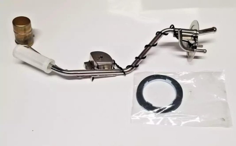

stainless collar, better seal, IIRC a bit thicker too
