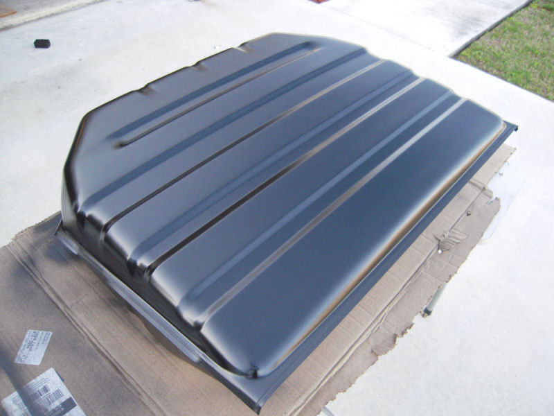

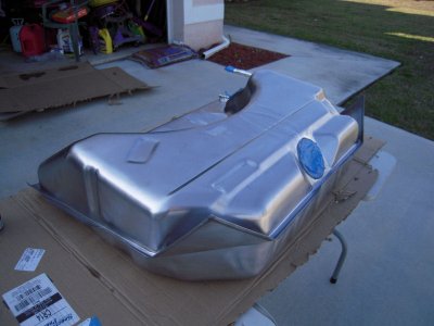

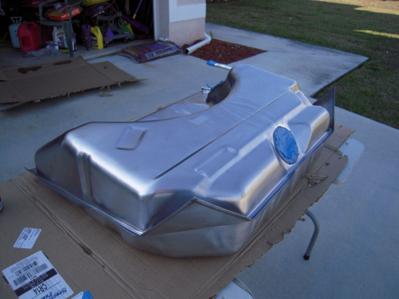

Ok..decision made..
Was 77 out today so I figured I'd tackle the project
<pause for cursing to subside ;) >
The tank as it was shipped was covered in oil.
-Cleaned the tank thoroughly with solvents
-Roughed it up with a Scotch-Brite pad
-Cleaned the tank thoroughly with solvents again
-Painted it. 3 coats were applied. 1 light coat and 2 medium coats.
I used "VHT Roll bar and Chassis Paint" in satin black. No primer required
"VHT Roll Bar & Chassis Paint is a one step epoxy coating that does not require primer. It gives the appearance of a tough baked-on finish that is chemical, corrosion, rust and salt resistant."
Came out really nice. I'll have to see how it lasts. May also hit the bottom with VHT undercoating once cured and installed in car. They have a type that can go over painted surfaces.
I also had the fill tube and tank strap sand blasted by a friend who does industrial sandblasting. The fill tube was plated so that was removed ( I meant to tell him not to shoot through the tube..hoping it does rust on inside now. ). I also painted those parts with the same coating
Here's a pic during prep and a finished shot. Paint not totally dry in pic.
