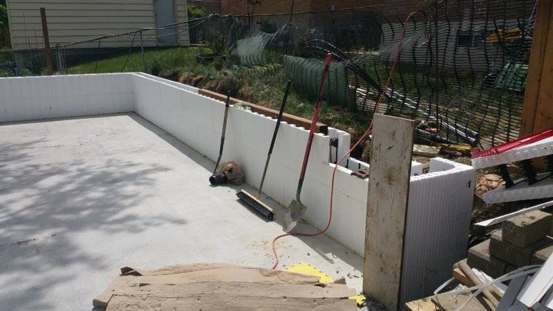

So needless to say the garage was temporarily put on hold. Fast forward to 2 weeks ago and I finished forming the new pad. 18x28, with a 16"x24" thickened edge. And 6" slab, I poured it 2 weekends ago monolithically.
Next I ordered Insulated concrete forms (ICF) To construct the 32" knee wall. My lot elevation is raised on one side of the garage so a knee wall will act as a retaining wall and a good solid base to build from.
I just poured the concrete into the knee wall yesterday and began to back fill the one raised side. I have lumber being delivered tomorrow so I had to tidy up the driveway to make room.

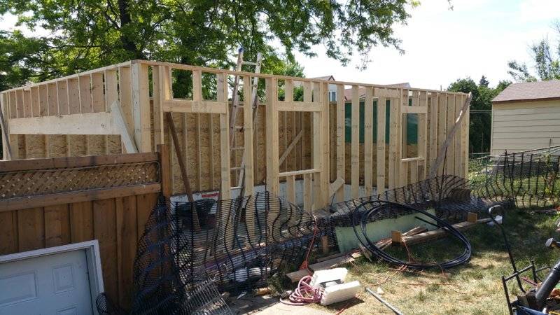

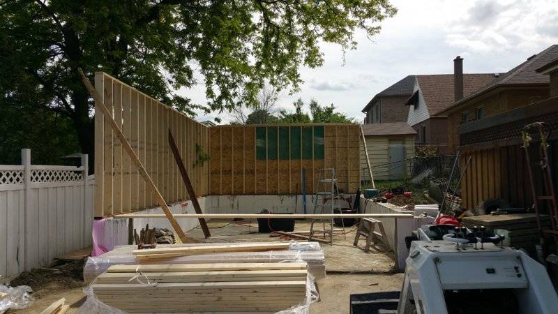

I took delivery of the lumber today and had a few hrs to spare. So I couldn't help myself and had to throw a couple wall's up. My father in law was with me and we got 2 walls up and the third build but not up yet as we were both beat from the heat and not eating all day
