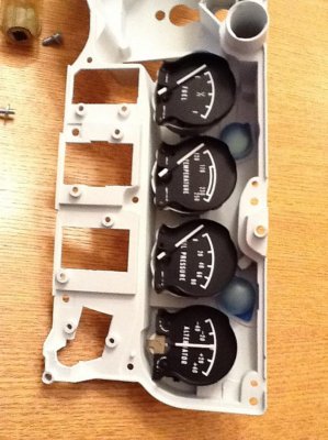

I restore the originals and calibrate my own. If you use originals, make sure you buy the solid state volt limiter for the constant 5 volts. IMG_0170.jpg
