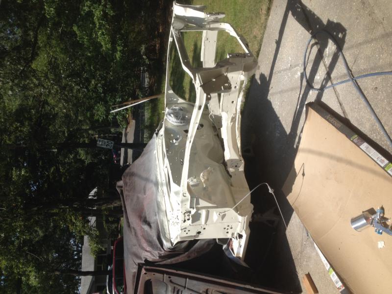

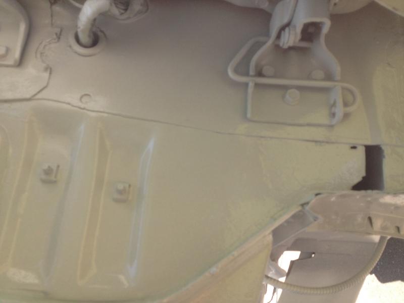

Watch for rot as pictured. Behind the door at the hinge areas, even more so on the passenger side.
Also where the hood bolts down onto the cowl.
I don't know if you can see or blow up the picture size to the passenger side where the door hinges go, but there and where the cowl' stop meets the firewall and the top portion of the hinge area is where the fresh air vent is inside the cowl. This area had a good bit of rust.
(Paint is Spiniker White. Taken and posted with the phone again, sorry.)
