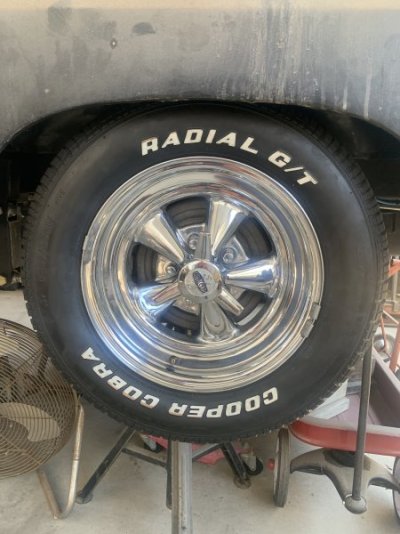

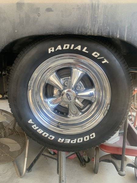

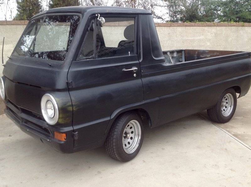

Thanks for the warm welcome guys and gals. I’ve only got one good picture of my truck. I’ll be adding more as time goes on. I’ve done a fair amount of work on it over time, but have quite a ways to go. So far I’ve pulled and rebuilt the motor (slant 6), swapped from 3 on tree to 727 auto, fabricated front and rear bumpers (originals are next to impossible to get). I removed the solid I beam axle up front and installed IFS w/rack and pinion and added electric power steering. Out back I removed the leaf springs and fabbed up my own parallel 4 link and panhard. Using air bags in the back and coil overs in front. Just recently I got a set of 15x7 Cragar SS with 3 bar spinners. They’re gonna look great for sure. I’ll keep updating as I go along. Again thanks for the welcome,Steve.IMG_0297.jpeg

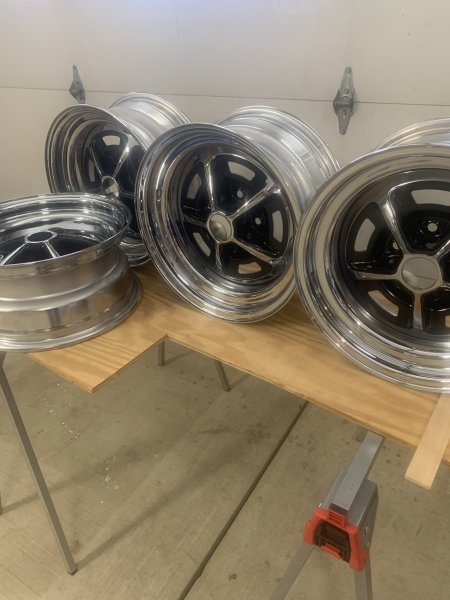

Parts for the electric power steering were scavenged from the scrap yard. Best place for it in a “kit” are from a place online called epowersteering.com. Nice stuff and knowledgeable people. My independent front suspension was a system put together from Chris Allstons Chassis works. They helped me quite some time ago. The rear suspension is a home fabrication I did myself. Had a pair of air bags sitting around from an earlier project and decided to use them. I may put an onboard compressor and self leveling later , but for now just manual fill. Truck still sits 2-3 feet off the ground waiting for completion. One of these days! Wanted to put a set of these on it IMG_2936.jpeg
but opted for these instead
