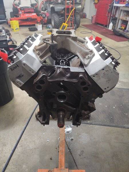

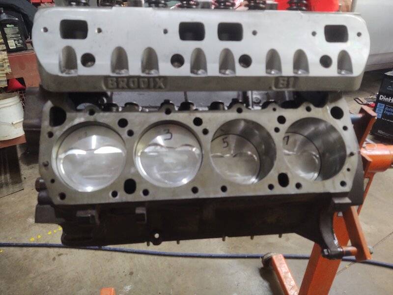

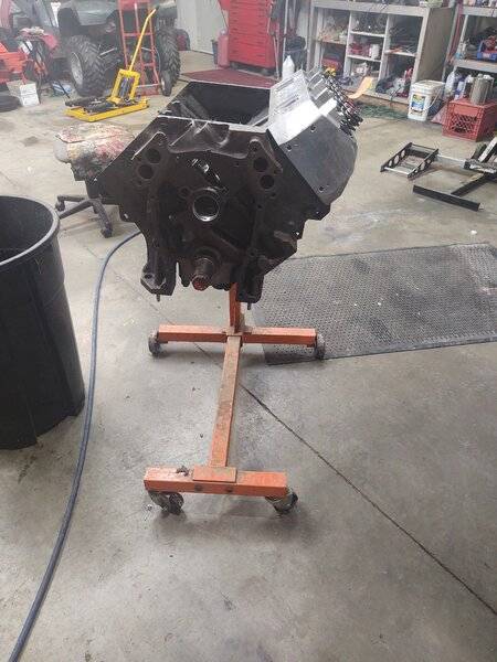

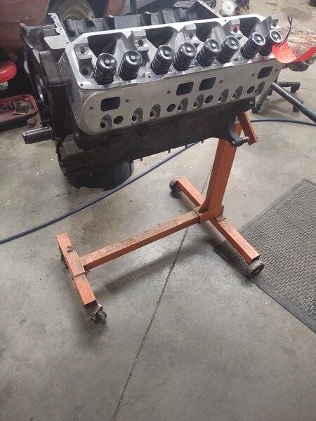

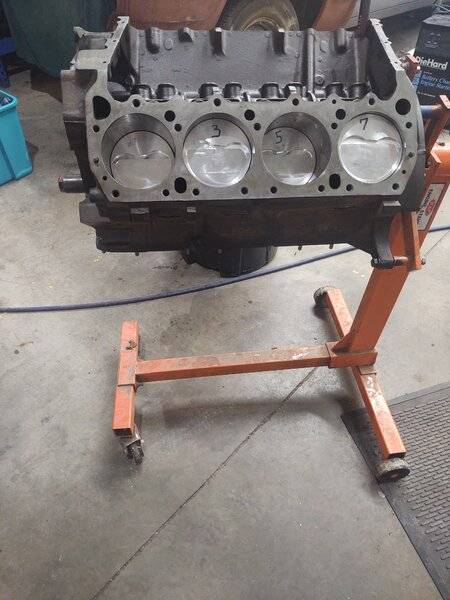

The pictures are of a humble beginning. 1971 440 HP block. Came with steel crank, six pack rods. I sent it to one of the better performance shops in Norman ,Oklahoma. I had them Line hone the mains along with the cam supports. The block was decked 0.010. The six pack rods had the beams shaved and smoothed, new rod bolts and rods resized. crank and rods are balanced. I have 10.5 : 1 Wiseco pistons with the lighter chevy wrist pins to loose a little weight. The Broix heads are 67 cc chambered I believe. I talk with my engine builder that built engines for my sprint car back in the day and he thinks it should put out 650 to 675 HP.
