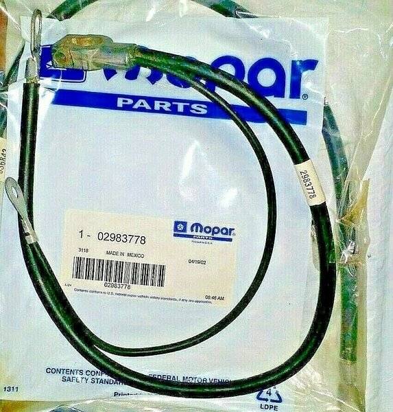

I am not sure of the exact part number for a 1970 ground cable but I believe it is like this where the second wire grounds to the radiator support.
I am not sure of the exact part number for a 1970 ground cable but I believe it is like this where the second wire grounds to the radiator support. Not sure if that would cause issues
I have that cable. My neighbor suggested to run a third ground from core support through bulkhead and connect to new bolt under dash — then run led flasher ground and anything else with issues to that such as back of dash cluster. Not sure if another ground makes sense.

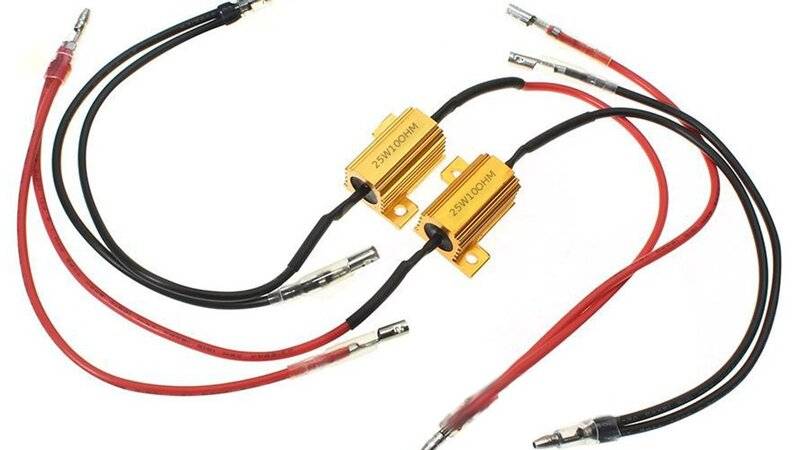

If I remember the rear lights needed this
Important note regarding indicator bulb
Replacing your indicator bulbs is much the same process as any other light on your vehicle, but with one important difference. Your car’s indicator wiring circuit has been set up for incandescent light bulbs which offer a particular amount of resistance. In comparison, LED lights offer little electrical resistance – and in layman’s terms this means your car’s indicators may “hyper flash” (flash very quickly) if you replace all the bulbs with LED’s.
In order to fix this, you must either purchase LED bulbs which are advertised as having the correct amount of resistance built in, or you’ll need to purchase separate resistor units which must be spliced into the wiring circuit to slow the flashing back down to the normal speed. This is obviously a more involved process, so if you aren’t confident with the job I certainly wouldn’t tackle it yourself without doing some research first and having the necessary tools.

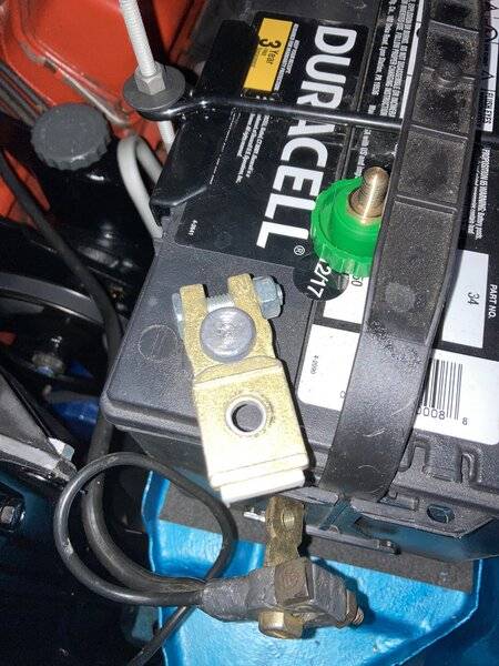

So, I recheck things again but realize that I have one of the battery connection disconnects. I wonder if that is what keeps changing since I disconnect it every night. What is best way to check voltage once I reconnect this thing or am I off?
So a possible update, I went through and checked everything, retightened, connectors and got tach to work. It was fine for two days. Putting key to accessory? (right before start) the radio comes on, turn signals work and all good. Today I got in and put key to same position before it cranks and nothing comes on again!
It will not affect anything unless it is not making a good connection when reconnecting it. Easy enough to diagnose when it is acting up with a voltmeter.
Why not just remove it and clean the cable end and battery terminal. Try it that way for a while. I had a job on a guys plow truck that used one of those disconnects. It ended up being the problem.
