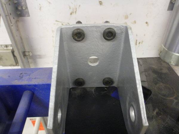

The leaf spring front mounts should look like this. Turn them upside down for about one inch of lowering.
Years back, I took some drag racing type spring hangers and drilled a hole in them up higher. A position 1 inch higher results in about 1 3/4" lower ride height. It also alters the differential pinion angle in the wrong way. THIS can cause strange vibrations, rapid U-joint wear and ultimate failure. I Pulled them out and put stock ones back in with the 1 inch lowering blocks.
