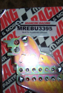

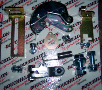

Well I ordered a kit from Mancini Racing, On their web site it look identical to that offered on the Bouchillon site, same pictures and everything, same price, same shipping times etc!.
It came in the mail today and while the parts all have a Mancini Racing sticker on them, the throttle cable bracket it laser cut with Bouchillon's BPE logo and packaged with the older style Mopar logo's on the packaging and the rest of the parts all have the Bouchillon logo on them.
So I think it's safe to assume that the Bouchillon and Mancini kits are the same.
Can't wait to install it and see it it cures my woes!
