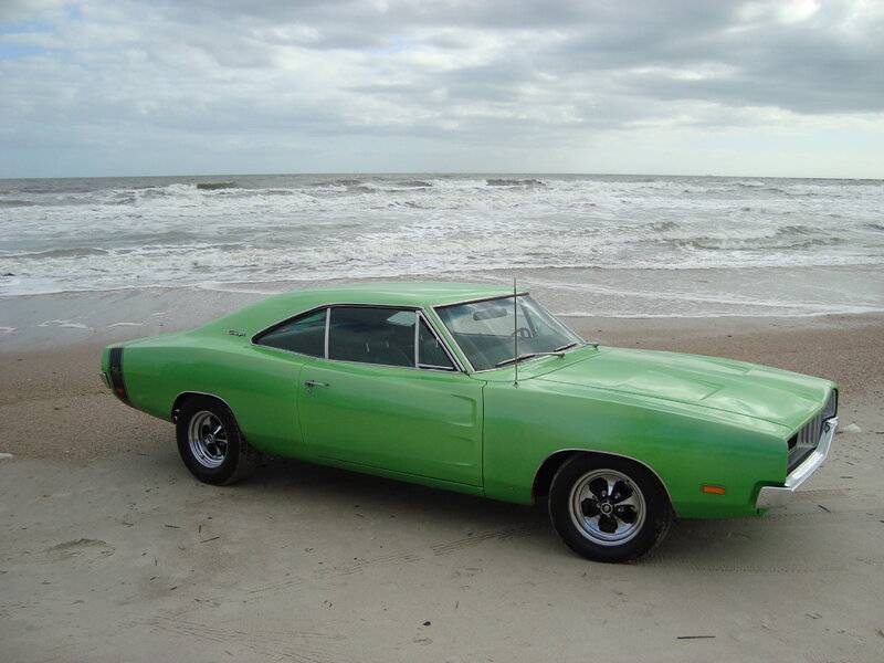

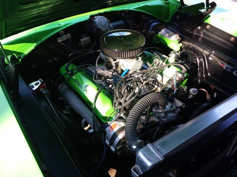

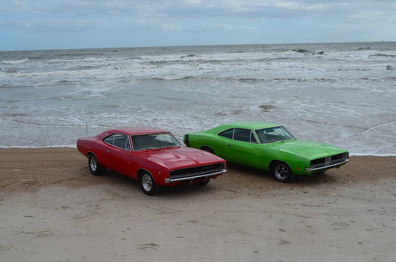

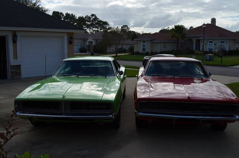

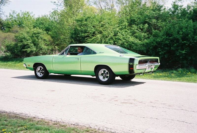

welcome to the site,any pics of the charger?
Thanks. Been reading the forum for a while so I finally decided to join. There is a ton of great info on here.The fact that my instrument circuit board burnt up helped too lol...
Here are a couple. Mine and my dad's 68.
