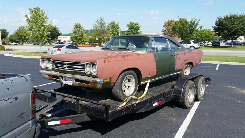

Thanks to all . the info is helping me alot ! Not a fan of these wheels , especially compared to the magnums ! 20150713_161952_0.jpg
Pic was the day i bought her. Done alot of work since . Alabama car , been in the state since new so im glad of that , only replacing floor pans , light rust and got new bumpers ordered and gonna be in all primer for awhile , looking foward to enjoying this 4 speed car . Dad had one when i was a kid , bought it off the showroom and hated to see him sell it and swore i would have one , just wish he was still around to help build it with me . After hours of reading the forums its opened my eyes and made me wanna push to finish her . Thankful for all advice , as this is my first mopar build .

Welcome to the site,,ahh a trailer queen
Good one 6_7_G_T_X !
LOL
PS, Scott, those are definitely "Day 2 " wheels...
And, actually not that bad looking at all in my opinion!
Anyway, good luck, welcome aboard and keep sending us some pics...
