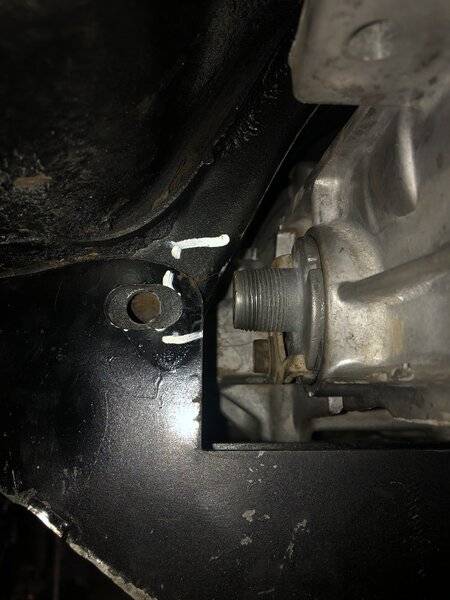

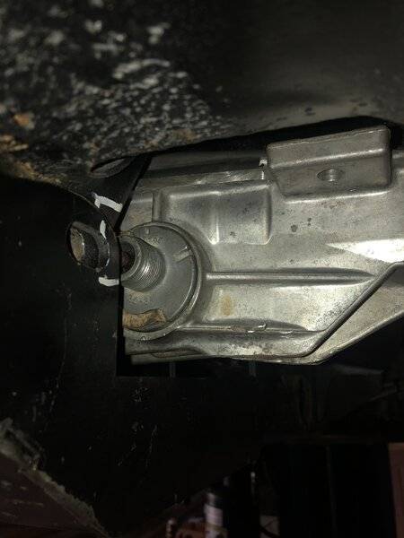

I am not sure if I should post this here or on a separate post so I will say what my problem is with the 46RH installation here now. I have managed with some heating & beating and trimming and grinding on the transmission to get enough clearance for the transmission above it in the tunnel but cannot get the speedometer cable on the pinion because it is right close to the arch in the body where the rear mount bolt on. I can't find anyone fixing that problem on a Google search. I am hoping someone here can help and maybe post some pictures. If the engine/trans were 3/4in further back it would go just fine. Also I am sure the speedometer cable will be too short as the pinion sets 7 inches further back on the OD unit. I would appreciate any help.

I'm not going to claim to be an expert on this -- I've only built one big block -- but if you went with the 400 versus the factory's 318, perhaps just changing out the k-member will get your transmission more in line with where it should be.

Welcome from central Indiana. Actually a few pictures of your problem would help to understand what you need to do.

Isn't there a replacement rear arch/mount bracket made to address that issue?
Involves cutting/welding.
Welcome from AZ... I would like to thing that an electronic speedometer would fix the problem. My buddy used one on his '37 Dodge with a 331 Hemi and a 518 transmission.
Ken I’m up the road from you literally. You’re going to have to notch the trans crossmember and fab the mount from what I was told.. Speedo cable maybe available from a truck! Guess what we need too! And of course welcome!:xscuseless:

Since I'm new to this forum I hope this is the way to post responses to questions or requests for more information. Here are two pictures of the problem area doing the 727 to A518 transmission swap.
