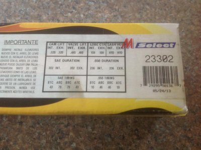

I know my pistons are well below the deck as well. I don't recall the exact distance. Lower comp too, 8:1! I have tried different cams too. I'm currently using a melling cam. I'll post the pic with info. I will say this, the runs very well on top end. Above 2500 rpm great and strong. I can't seem to get the darn thing to go good with lower rpm.

the .050" duration, lift and LSA are nearly identical to the 284-.484 mopar cam. the Melling seat numbers probably include the ramps. more cam than i'd run with an 8:1 383.
