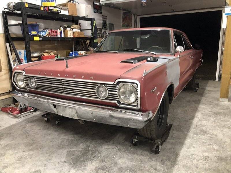

hey y’all
Am putting super stock springs in and the spring hanger with for 20” front leaf section are non existent...?
Also been reading on the old update for dual master from single pot. ‘67 dual master and then the two lines leading into the proportion valve? Rock auto has the dual master for cheap!! But where do I find the two lines to proportion valve and keep the rust the same. FYI all drums for now but looking at Scarebird for the front disc change. Is it worth it? I think it was listed as ford or Lincoln calipers...?
FYI, loving the Mopar help etc, had lots of Chevy, GM stuff up in Canada so I have had somerar Acadian, Beaumont over the years but the Mopar family is TIGHT!
