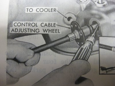

Cable operated transmission cables are adjusted by the control adjust wheel where the cables enter the trans. Do you have a FSM?

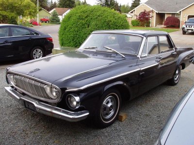

Push Button Shifter Bracket
P4300002.jpgHello moparsteve636; I have a 1962 Dart project. I need the bracket that attaches the push button shifter assembly to the dash as well as the park lever. Would you happen to have any of this or know someone who does? Thanks, Scott
