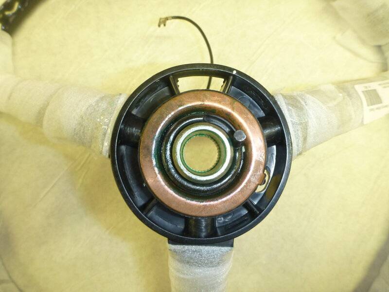

Cancel "coil" on the hub needs to be realigned. They'll move by tapping the "post" in the direction that opens the spring coil enough to release the hub.

Another way to tackle it, the wheel in your photo, does that one wheel correctly as adjusted
I had to rotate that a bit clockwise (looking at it as shown) to match the OE wheel I took off. Remember it's cancelling the signal, so if Left is cancelling early you will need to move the coil post CCW when looking at the wheel as show above. The not cancelling when turning right is hopefully not a broken cancel arm on the switch assembly. If you turn the wheel further left, after turning right, ie after straightening out, yank the wheel into a left turn, does it cancel?

dadsbee gave me the likely solution for the turn cancels on the steering wheel itself. No, everything stayed in place as I swapped the wheels.
