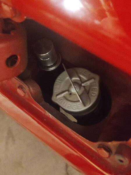

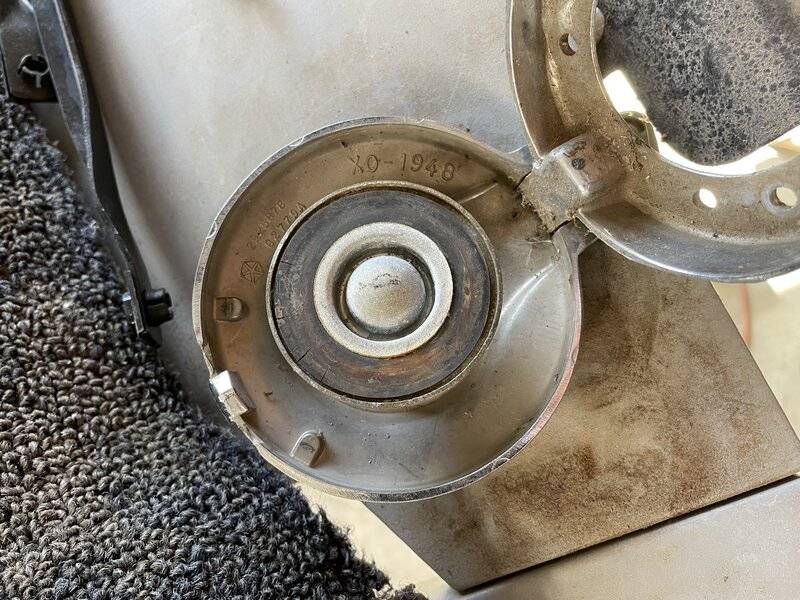

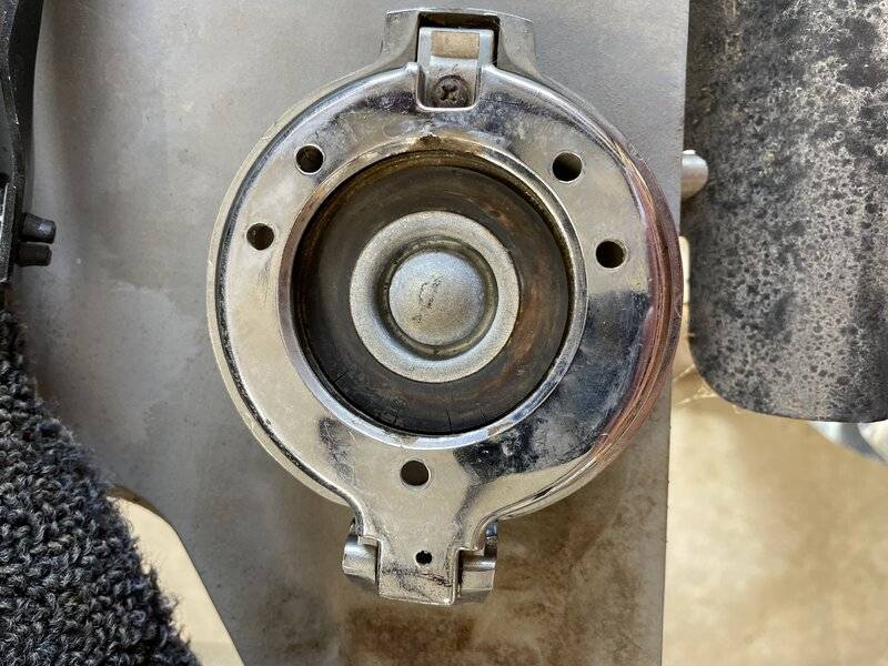

So it turns out, the stock cap is not vented at all. It’s solid and spring loaded. A tank vacuum will seal it tighter.
I have no idea how a stock tank gets vented.

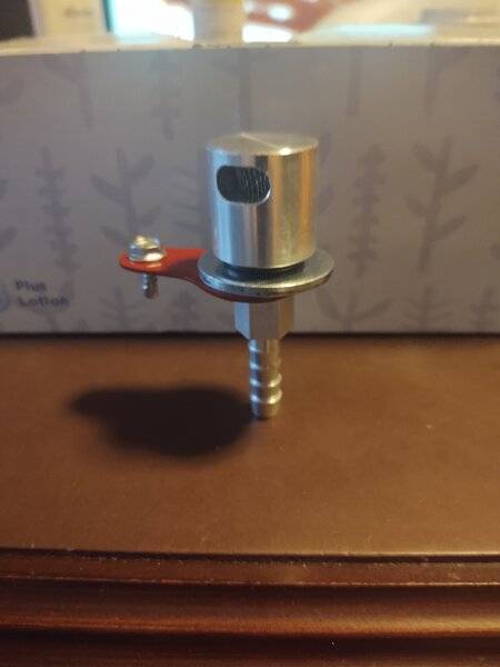

The Tanks inc tank came with a check ball and a y
The Tank had a vent nipple added behind the pump shelf and the Pump itself has a vent
These were y's together and mounted inside the filler door
I used 6an line (3/8) for the vent lines and the return line
8an for the supply
Did the same as TN Mopar. Used a roll over
check valve, bug screen, charcoal
master cylinder booster line filter, sealed
cap. Inexpensive and easy.
No fumes in the garage.

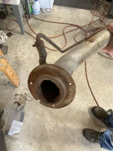

On my 69 Charger I'm just using the original vent tube. It attaches near the top of the fill tube and goes through a grommet in the floor, open to atmosphere inside the frame rail.
All other vent ports I have blocked off.
That's with a Walbro "hellcat" 525lph pump running full voltage all the time.
I don't think anything else would be needed. If so, could run the factory configuration with a bigger tube from the filler down through the frame.
