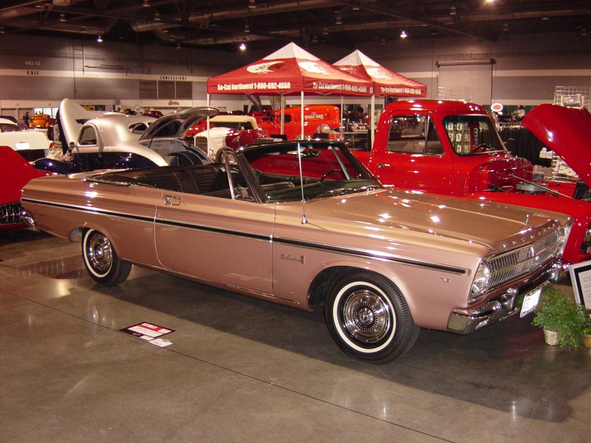

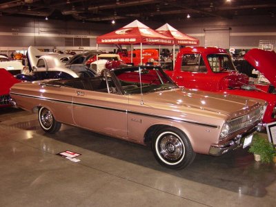

I've been driving this 65 Belvedere II convertible since '65 so PM me with questions if you get stuck. I do have a set of stock upper and lower A/C vents if you're convinced you want to go that way. Enjoy the project.......
