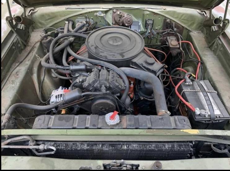

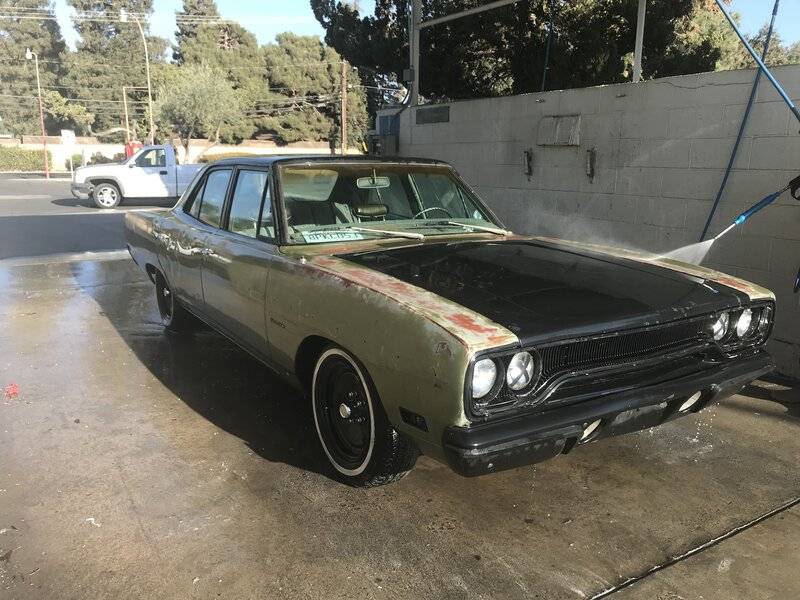

I just picked up a 1970 Plymouth Satellite sedan. I know absolutely nothing about mopar either, as I’ve only ever worked on Toyota and GM. Bone stock 318, 904 auto according to the fender tag and my eyes.. lowered by previous owner but not much. Biggest problem is electrical, and power steering leaks. And the brakes pull hard to the left. And where in the world is the dipstick on a 318??? I can’t find it anywhere.

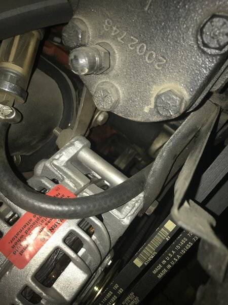

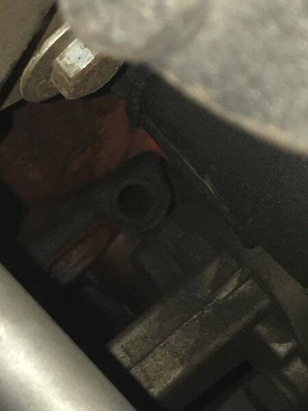

Nice ride. Dipstick should be between the alternator and ac pump or possibly below/beside the alternator. Tube might be there but missing the dipstick? Brakes pulling hard left probably means your front right brake isn't working. Could be the hose is collapsed. I had that exact same issue on my satellite that had sat for probably 2 decades.
Nice more door! Could also be frozen caliper.
Ditto on the dipstick, Jimmy!
Looks like a new alternator, too!

Welcome from Missouri!! See it by the alternator.

Finally found it. Need to get ahold of the tube, but I have a new stick.
