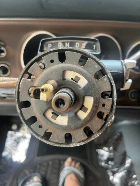

I have a 1971 Plymouth Satellite Sebring Plus, I need to replace the turn signal switch, I have removed the steering wheel, but there is a metal ring that I can't figure out how to remove. None of the videos on you tube show a ring like that. One thing that I saw said push in and turn counter clockwise, but it only pushes in a very small amount, and won't
turn
turn.

A picture of the whole car would be nice but I guess an undressed steering column will do for now....

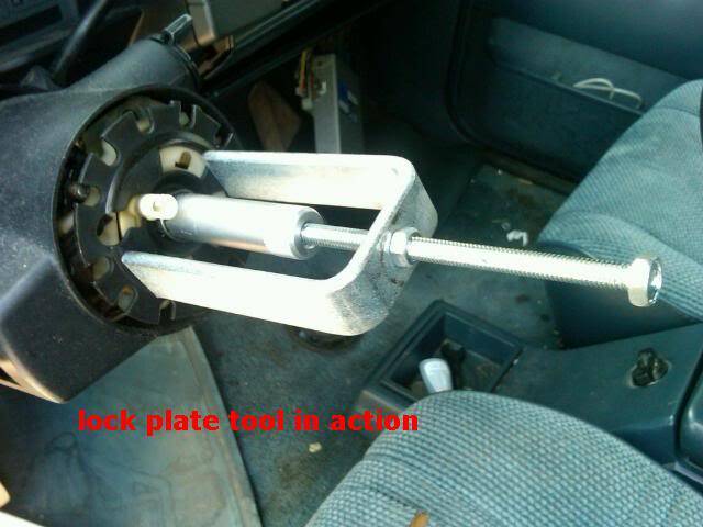

I think what you are looking at is the steering shaft lock plate. I'm a 69 so not sure on 71 but found this.
Here is a C-body thread but not sure it would apply to yours.

You were correct, I went to the local Napa auto parts store and bought the lock plate tool and was eventually able to get the ring off. But as is usually the case I ordered the turn signal switch that Classic Industrie's said would be the correct one, but this one only has 6 or 7 wires and the one that I need has 11 wires. So once again we wait. Thank you for your answers.
