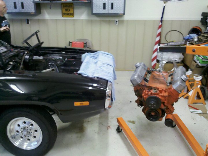

Pretty good I just took the power booster out gonna run a manual brake set up because im pretty sure the hemi will hit the original booster that was in there and the manual brake setup is 89 bucks, running a set of line locks. I have to call and see if the proprtioner valve will work or not, dropping a 9" converter in today with a 5k stall from turbo action should be a hell of a ride when done, also have to run a 1/2" fuel line for the dual quad setup. Its a work in progress trying to get her ready for mopars @ e-town next week.This pic is the 440 taken out of the car.
