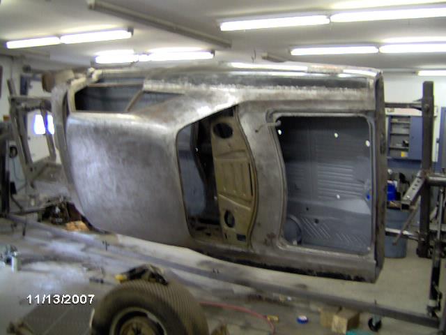

Hello b-Body forum,currently working on a 68 super bee restoration,completely stripped and rotissoried,getting ready to start shooting paint.

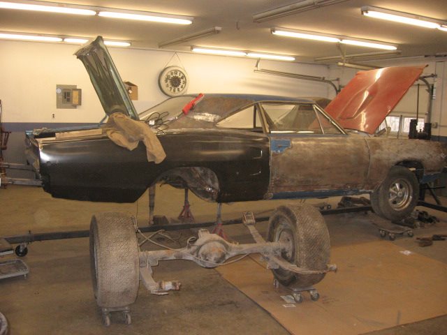

Would like to run the biggest tire I can on the back, anyone know the best offset to use? Tires in the one pic are old L-60's,width is good but I think I could go taller.

Look,s like mine back in the mid 90,s. I,m running 295-65R15 drag radial on a 8" Weld Draglite with 4 1/2 " backspace
