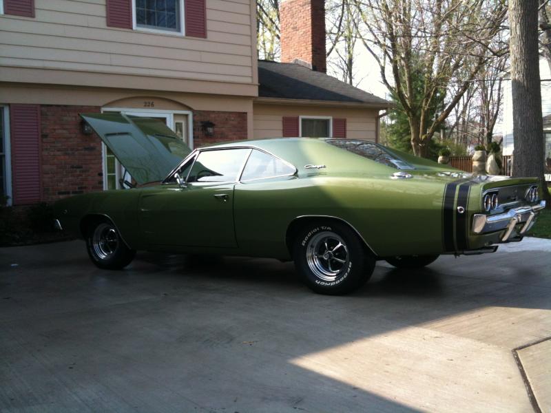

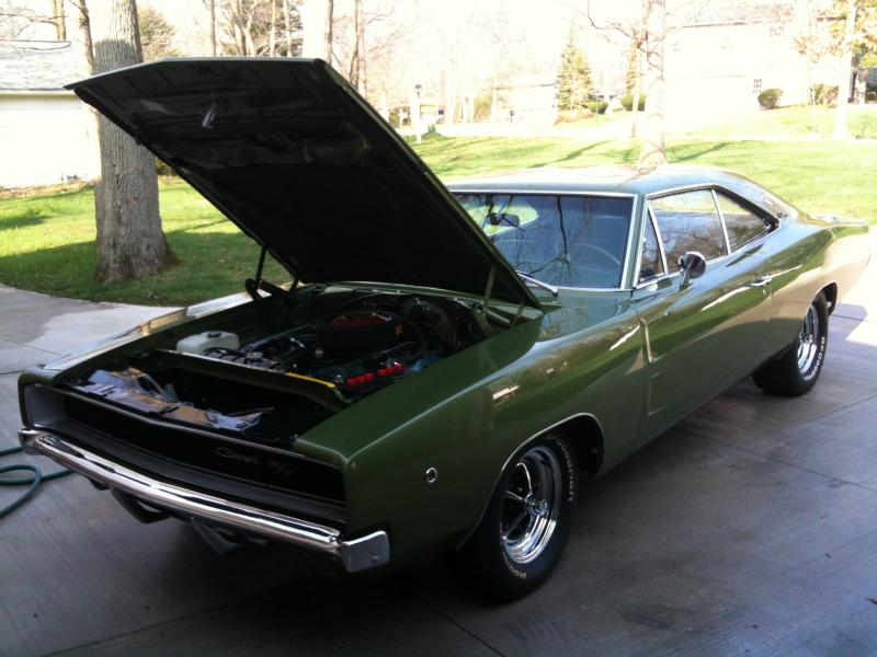

I posted pics in my photo album, but here is a few.
I put some more pics in my photo album. I'll add more pics as I get to know the car better. These shots were all taken the weekend of purchase.

thats a beautiful machine. a few loose exhaust bolts are not a big deal in comparison to what you have there.

Congrats. You made a fine purchase.
Nice looking car. If you have a set of 3.73's all set up, you should drop them in and see if you like it. It will be night and day difference from what you have now. The car probably came with 3.23's, 3.55's, or 4.10's from the factory. 373's were not an option back then.
