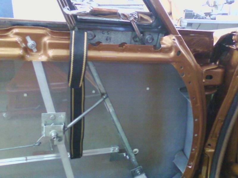

I made my own out of Lexan. If it's a hard top you will need to build a tube to support if you want them in a fixed position. I've done a few. My 63 hard top actually went up and down in the factory tracks. Used 1/4". Reattached the stainless from the factory windows to the Lexan with RTV. They were a little floppy but worked fine. In fact just saw pictures of that car, It still has them. They were done in 1991. My 64 Belvedere sedan uses 1/8". They also go up and down with a strap. You can make a template from the O.E. parts The edges can be sanded with 150 grit for factory appearance. Leave the protective paper on until completely done. The rear glass is easy as well. Mine is in the factory rubber channel. Removing the side and rear glass along with the regulators saved 88lbs. Done correctly it looks factory. Yes the ventwindows are Lexan as whell.Holds up pretty well. Current car has been raced for 13 years.

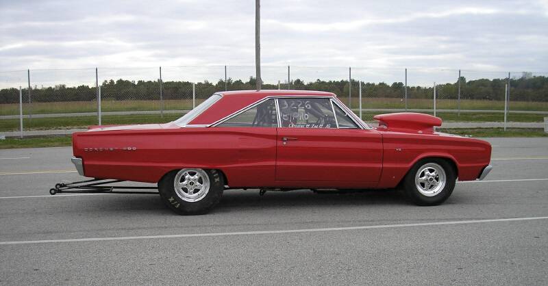

I'm going to lighten mine up some more, but mine are 1/4" thick (I think - need to measure) lexan. They are fixed in place. The doors are gutted. Severely gutted. Been like this for almost 25 years.
