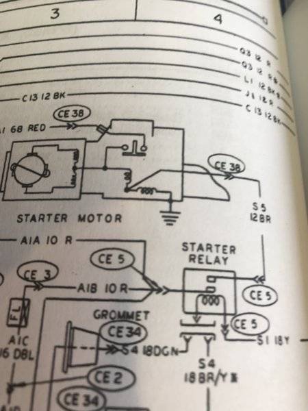

Just now see that the starter solenoid wire is grounded.
Yes lol the rotor is in and I lifted the contact.
I jumped 12 volts from the battery to the poss post on the primary of the coil and I have spark. I keep getting strange numbers on the ballast so I bought another but get odd numbers there too. Box had been opened though so who knows.
Found the solenoid wire to the starter has continuity to ground. I can’t imagine that’s right any thoughts???
I believe the solenoid is just an electromagnet so yes you should read continuity to ground.
