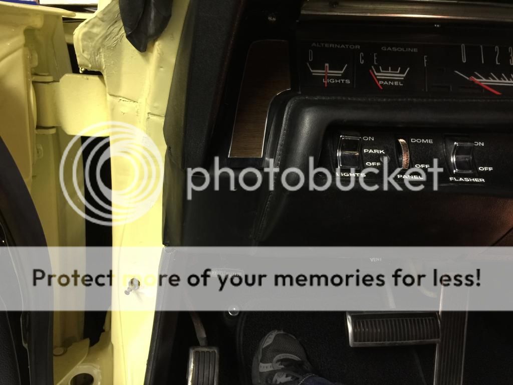

It appears that I am missing a trim piece of my R/T with a sweep speedometer. The dash has a hole and just below the wood grain trim piece on both sides. There is a hole for a screw, but is this normally covered with a trim piece or is it plain like in my picture?
I would say you are missing a small wood-grain piece, underneath you will find the second attaching hole for that piece.
I know this is a '70, but you get the idea...
:hello2:
They are reproduced in the standard black for sure, and I think I remember seeing the woodgrain ones also, but you might have issues getting the new ones to match the rest of your pieces.
